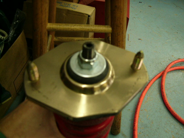

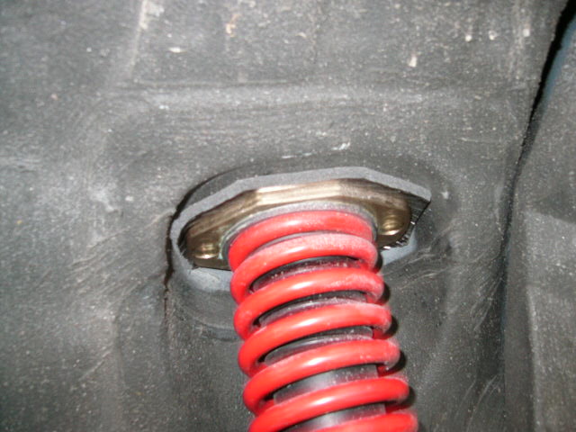

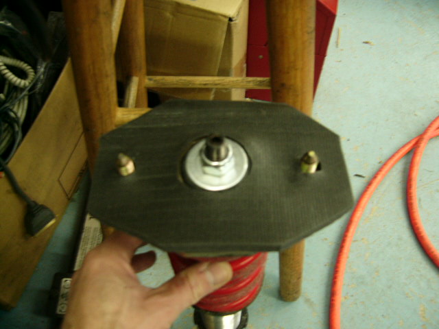

Well after fighting with this noise for a month now, I finally figured this out.
The top of the coilover has no rubber gasket. So when you install them the
mount is metal to metal with the body of the car,so all noises get transfered into
the body hence a clunking noise. See below on how I cured this.

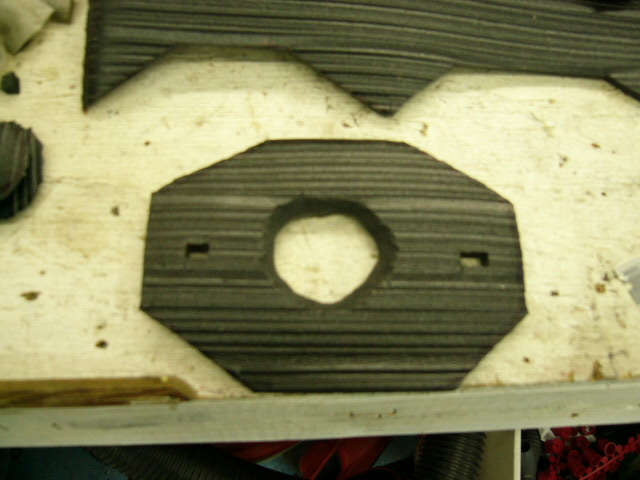

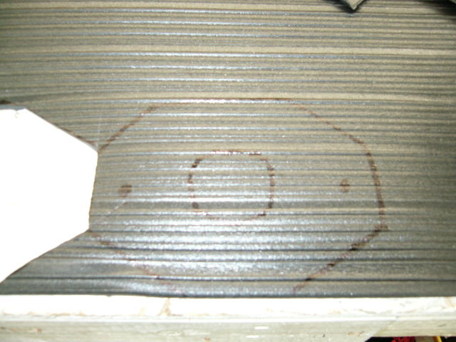

Please explain in detail the solution. The clunk from my right front coil over is driving me nuts. The pics are good, but an explanation would help. What is that black material you cut out and installed?
Thank you

I dont know what trpe you have but most of them do not dave a gasket between the body and strut mount.It is a metal to metal mount. There for I put a rubber gasket between the two parts. Look a my photos. It worked great. No more noise
