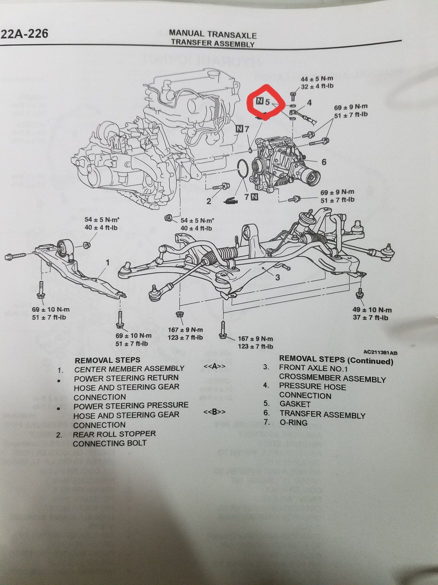

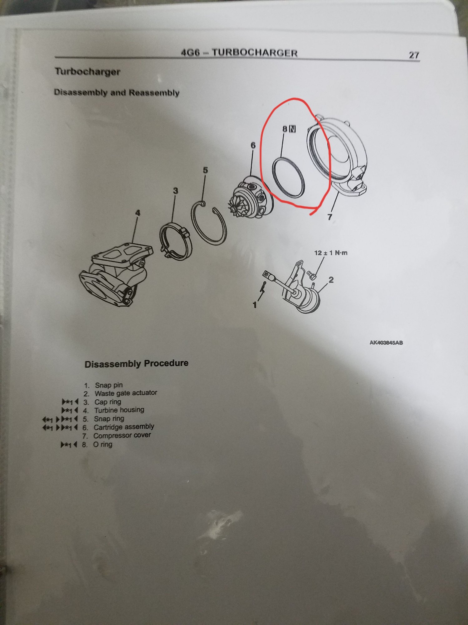

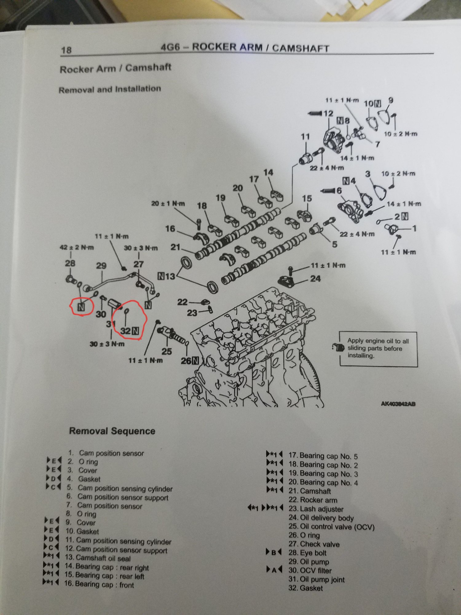

Washers and o rings
06 evo 9, I cant seem to find these last few parts in the correct size anywhere online.. any info would be greatly appreciated.

Item 5 crush washer for the front diff shows to be: MF660065
Item N gasket shows to be: MF660066
Item 32N shows to be: MF660065
Item 8 turbocharger O-ring = MD613777
All these no.s can be found on https://partsouq.com/

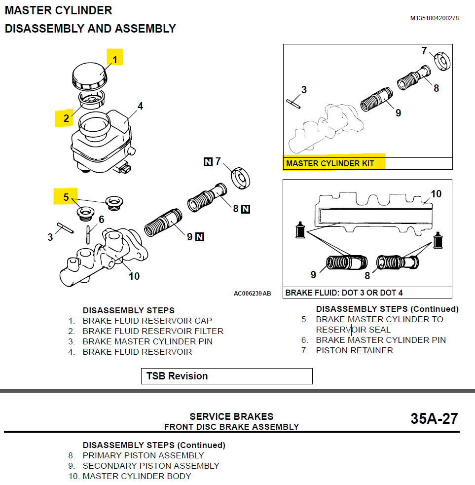

Hi, I have a 2003 Evo 8 and would like the part numbers to the 4 highlighted pieces below to rebuild my master cylinder. Thanks.

I checked out partsouq because I was interested, but couldn't find the PNs there. Anyhow, I loaded WinCAPS and found these:
Cap: MR475354
Filter: MR569000
Seals: MR244929
Cylinder kit: MR569906
Hope this helps.
Quote: Hi, I have a 2003 Evo 8 and would like the part numbers to the 4 highlighted pieces below to rebuild my master cylinder. Thanks.

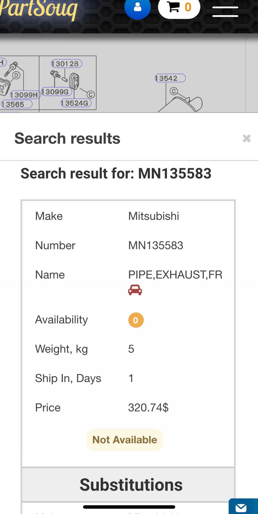

Stock Evo 9 Downpipe
Hi,
Due to State Ref (here in CA), looking for a factory/stock downpipe for my Evo 9 as I threw mine out awhile back. Part number listed at beginning of thread says "MN135583" however its not clear in the thread if that is for a 8 or 9 and as I recall, the downpipes are slightly different due to clearance issues...
Doing some brief searching on the MN135583 part number, it is listed as for 2003-2005 model years, which would just be then for the Evo 8. Looking at online Mitsubishi parts catalogs/vendors, they all give me the same MN135583 part number with my VIN entered, but not sure how accurate they are...
Is there anyway to verify the correct P/N for the downpipe for an Evo 9?
Thanks!
-Jason

Thats the right part number. MN135583. I also think they are all the same downpipe. Fitment issues were the early aftermarket downpipes when they came out with ACD. The shops then had to make new downpipes. I’m not 100% sure though. That is the right part number for the Evo 9 though.
https://partsouq.com/en/catalog/genu...ah36c16u034321

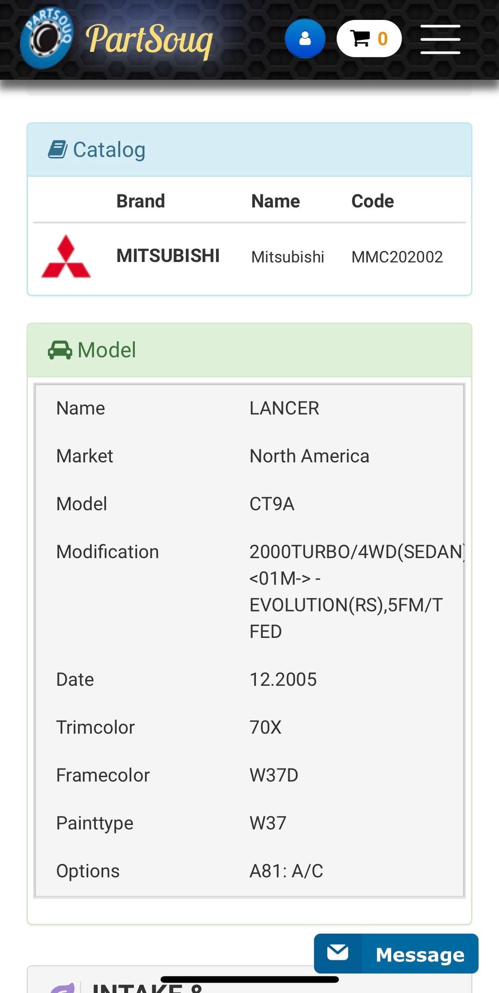

This parts lookup website will help ya (takes a little getting used to, but works pretty well)
