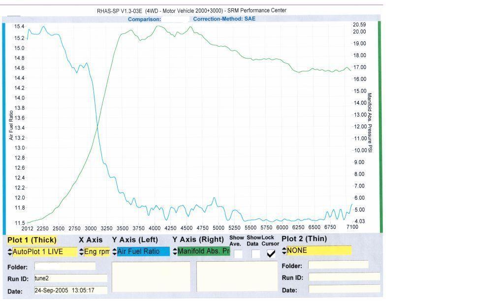

Ok here is the story. I got my ECUTek flash at srm performance center (very cool guys ) . My car got dynoed. (See images below) The boost doesn't hold and peak HP gain from the tune was 8hp.
I showed Tyler@Works (very cool guy ) my dyno graph. He thought the flash wasn't too good and the Works P2Flash can do better.
He offered me a super big discount (pretty big) to trade a brand new stock ecu with the P2 Flash (which is promised to hold boost to redline, and a promised higher HP gain) in exchange for my current ECU with ECUtek (and the ecutek license).
Now I did some research. My big question - is it safe holding 20psi to the redline with everything stock? (i'm getting a jdm mr bov soon)
Please help me decide here, thank you in advance for the comments.

You should probably do some research about switching ECUs, because ours are not interchangeable due to the immobilizer. Unlike with DSMs, you can't just exchange ECUs, unless I'm mistaken.
Anyway, as for what PSI is safe to redline, again you should do some research. Not only is 20psi safe on 93oct, but so is 21 or even 22psi. 21 is better than 22, because it won't cause knock. 20 is fine, but there's no reason not to run 21...

I would advise you to get the car retune with Ecutek since you already have the license. There's nothing Ecutek can't do that Works P2 flash can do.
