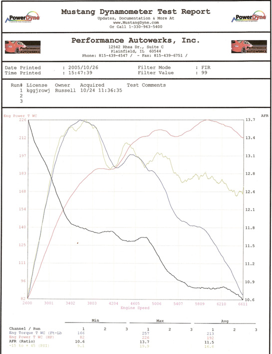

Actual dyno plot post
Here is the dyno plot smoothed out and filtered for everyone to look at. The number that was originally talked about was a spike in the graph due to incomplete filtering by our dyno during the run.
This is on a stock 2005 EVO. Seems pretty consistent with what we have seen on our dyno.
Dave
It may be consistent for what you see on your dyno, but not consistent with what Evos run on OTHER Mustang Dynos. To do 250+ torque on a Mustang dyno in stock form is still insane. That's about 40ft-lbs too high. That's higher than stock 05s on a Dynojet, but the WHP is only 10-15 too high for a Mustang (within reason).
