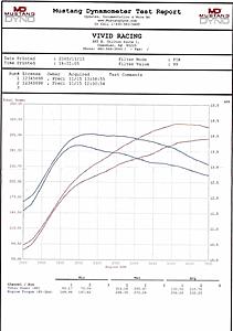

Baseline = Dynoflash. Hmm...........all i can tell you is you are 100% WRONG! I had the same mods, running the same shell 91 when you tuned me in May 2005. Btw i'm one of the 5 that had your dynoflash and got re-reflashed, all were very impressed with their "re-reflash".
Originally Posted by DynoFlash
Finally on 91 octane fuel such as you guys have in AZ - in many cases you are not going to "feel" a giant power gain from proper tuning. Its not going to give you a feelling like you just added cams or a larger turbo.
