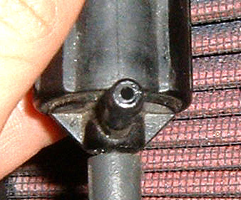

I bet he is talking about the BCS restrictor...common free mod to get a few PSI out of the 1 and 2g's.

Oh and to add you can do it yourself with a drywall screw. Just remove the hose find the nipple with the restrictor in it...take the screw and turn just enough so the threads bite into is and pull it out here's a pic of the nipple..if you look closely you will see the inner part is a seperate piece...thats what you want to remove.. (pic is from a 1st gen)
