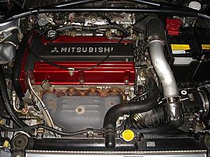

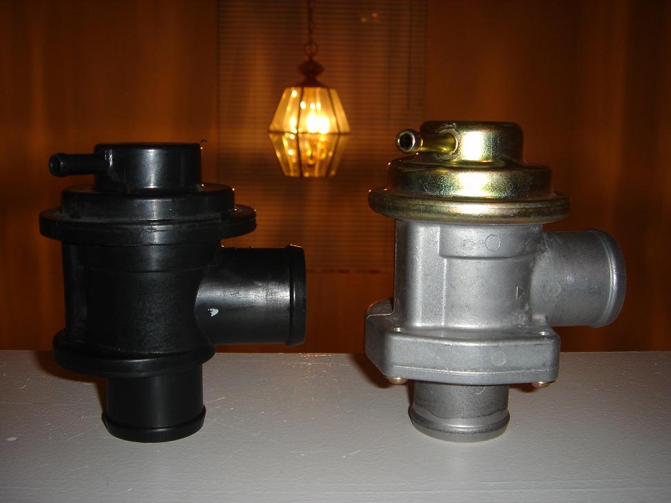

correct diveter position
A lot of people never realize this, but on the stock DV there is a little arrow symbol on the side of the opening end that should be facing down. I noticed on my old 8 DV that there was some white paint in the same area designating that point. Look for this arrow as shown in my picture comparison. I hope this helps.
