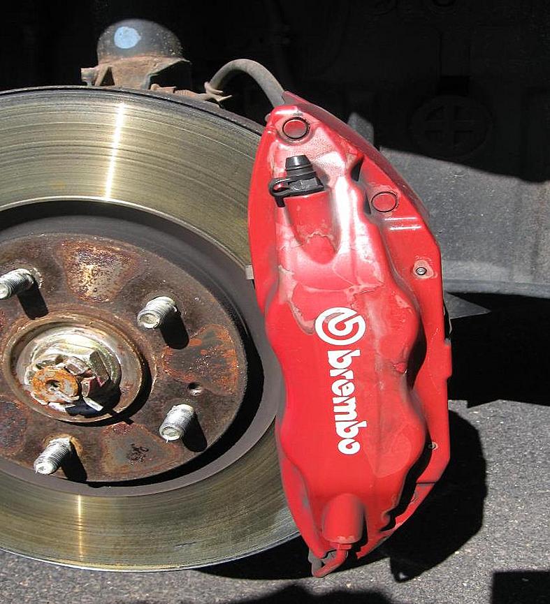

I finally did this this past week. Came out not too bad, certainly a lot better than they were. I used a credit card to scrape most of the clearcoat off both front calipers. The original clear on the bottom backside was still good, so I just sanded the edge of the old clear there to make it even.

Originally Posted by Nasty Evolution
Has anyone had to replace the Brembo logo.. mine is not so white anymore. I know they make stickers but I question how well those would hold up even with layers of clear over them.
I did not replace the logo. I scraped around (including in between and inside the letters) and a little more lightly over the top.
I used the VHT Satin, but I think the gloss might have been the better choice. Either way it is much better than before.
