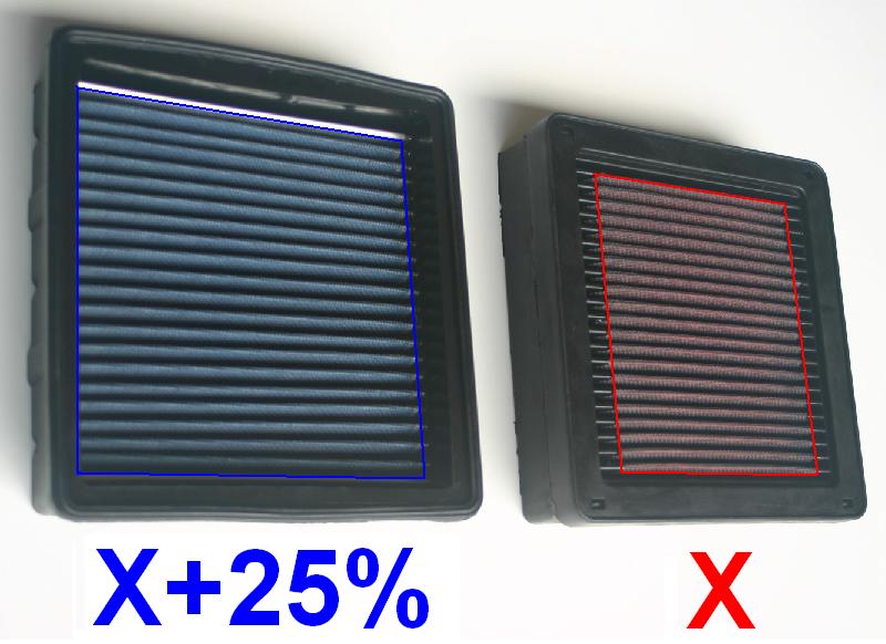

I've seen a pic of the K&N filter compared to another brand, and the top surface area was actually smaller. The thickness is pretty deep like the stocker but the square top surface seemed small. Maybe this has something to do with it?
