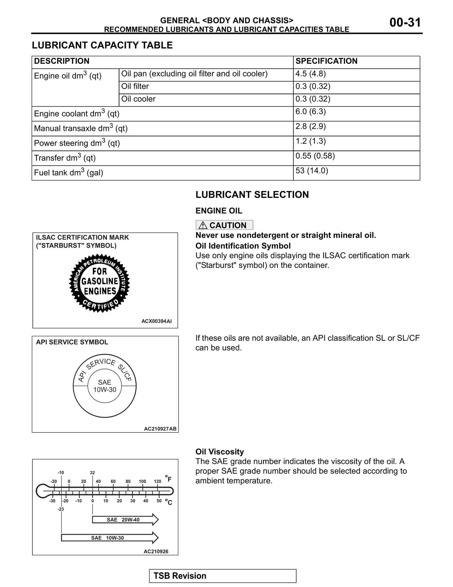

I was just wondering how much gallon can a regular or stock evo 9 fuel tank hold? Sorry to ask this question but I cant seem to find a thread about this. Thanks!

I think its 14

off the top of my head I remember 12+ gals.

14 gallons

Correct.

I realized this thread is old, but I can confirm this number. I just filled up my tank with the needle pointed at the "E" and I added 13.7 gallons!

always thought it was 12 until i filled up and was 13+, hahah, thought i had a hole in the tank

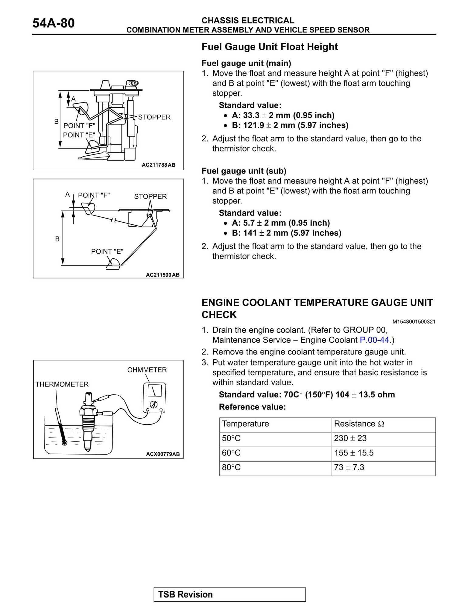

Hi Guys need your help, my gas gauge is no going pass quarter tank or three quarter tank why is this?

Probably a sender problem in one or both tanks.

I just got 13.8 in there. Really pushed it..

It's a 14 gallon tank officially, but I actually got 14.2 gallons in there before. Drove it to the point the fuel gauge stopped moving and then kept going
