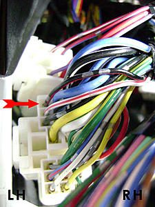

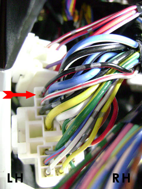

Old Mar 2, 2009 | 04:01 PM
binarysleep's Avatar
Posts: 257
From: Igloo
Originally Posted by EvoGLH
I have an early (March) '03, and have 3-wire mirror connectors. However, I have seen 7-wire connectors on another early (Feb or March build) '03 Evo ... unfortunately, all attempt to obtain the mirror harnesses/connectors from him failed.
I checked the connector running into the door and none are for heated mirrors.
1. radio
2. radio
3. ground for windows & lock
4-6 lock
7-8 window
9. empty
10-11 window
12-13 lock
14-15 window
16. lock
17. window
18-20 mirrors (remote function only)
Attached Thumbnails heated mirrors-driversside.jpg   heated mirrors-heatedmirrorwire.jpg
Last edited by binarysleep; Mar 3, 2009 at 01:11 PM. Reason: edited to correct info
