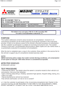

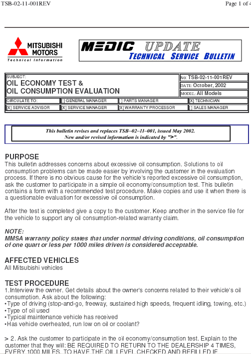

Mine uses about 1/2 quart per 3000 miles. For the first thousand or so it didn't use any.
Mitsu says that 1 quart per 1000 miles is acceptable! That's ridiculous.
Attached Thumbnails Caution : Dealership says to watch....-pic.png
