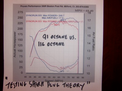

This is why we at Dyno Flash test everything before we open our mouth !
For example we have tested 6 different cam combinations to find the best one
Here we have A - B testing of the same STOCK car with regular 91 pump gas and then 116 race fuel
Obviously the ecu gets less knock signal and then runs more timing = more power
Its important to TEST and VERIFY before you state facts

Al that rocks! Mitsu did us right on the computer, so any reflash / piggy back just put in the good gas and have fun!
I don't think the poster was interested in knowing how cat-poisoning leaded gas would perform compared to 91 - have you done any 91 vs. 94 tests?
Exactly - you notice the bigger gains come at the end of the run when the ecu really adds in big timing
