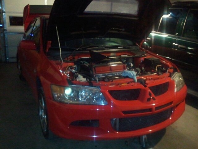

yesterday i was replacing a taillight bulb and i decided to get rid of the carpet on the passenger side bc it would look better bc i have my battery relocated to the truck. i reconnect the battery a few times to check a few things then i finish. i did not move any wires or anything. i reconnect the battery and i realize my dome light doesn't work i go to start the car my cd player doesnt work and either does the clock i go to start it and the battery is dead. i charge it start it and check the fuses none bad for radio or anything. i drive back to my apt and it starts having really bad voltage drops i make it home and get a new battery bc the one in it was really bad and would replace that before the alternator after that i realize keyless entry does not work and i can lock or unlock doors with button unless key is turned. i have no idea whats wrong any help?
so problem:
unhooked battery a few times causing
no dome light
keyless entry
clock
or locking/unlocking automatically unless key is turned
please help with any info bc i miss my baby having a good electrical system lol.
thanks for any help!

check fuses inside the engine bay and drivers side panel left side of clutch pedal.
Old Dec 18, 2010 | 02:04 PM
twnty100drummer's Avatar
Joined: Feb 2010
Posts: 41
From: IL
This. Check the 2 fuses under the hood that are in the yellow clip thing. It's one of them that is blown, that's why the done light, clock, radio, and keyless doesn't work. Mine did the same thing when I swapped head units

Pull the drivers side kick panel and there are connectors there. Its probably corroded and green. Plenty of threads about this

thanks of course the fuse i was like nah i dont think thats it god the simplest things. THANKS EVOLUTIONM!
