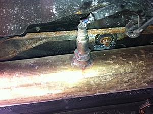

Ok here is the picture of the O2 on the test pipe. ( SO is this my problem?) I was wondering is it damaging anything since its saying check engine. Is it maybe running to lean or rich.

I don't know but the picture looks like the two wires are cut,fuzzy picture though

Ill double check that right now

The reason it did not show what bank on the code results, is because a inline-4 only has one bank.
I firmly believe that the test-pipe is causing your CEL to come on.
If you get the sensor out of the main stream exhaust flow, it will think the catalytic converter (that isn't there) is doing it's job.
My hollowed cat causes the same problem, but I'm too lazy to do anything about it, instead I just use my scanner to clear the code when it comes up.
Good luck!
