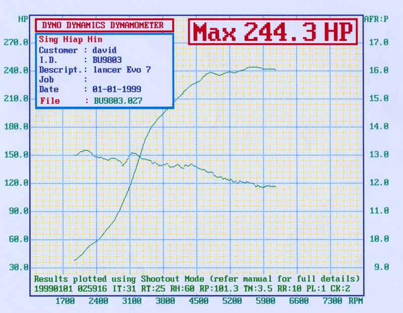

The image below shows est. power at the flywheel though i think this is not accurate... the next one shows road hp...
I dont have one at stock though.. so i would appreciate if anyone could post theirs.. pls include your intake temperature (atmosphere) and fuel ratings..
NOTE!!! This is not for comparing who's got it bigger... its for the analysis of tuning techniques and products... what we need to do is to collect all these data together so we can use them to help in the tune ups for our beloved road machines
DYNO used is Dynodynamics AWD dyno... and running under shootout mode 44.. note: If u use shootout mode 4 you will get a much higher rating as the 4 is for 2wd cars... my initial run without any mods got me 308hp at flywheel with just an exhaust, filter and plug cables and hence are over-rated.. so please post shootout 44 results because EVOS are 4WD cars..

Road HP

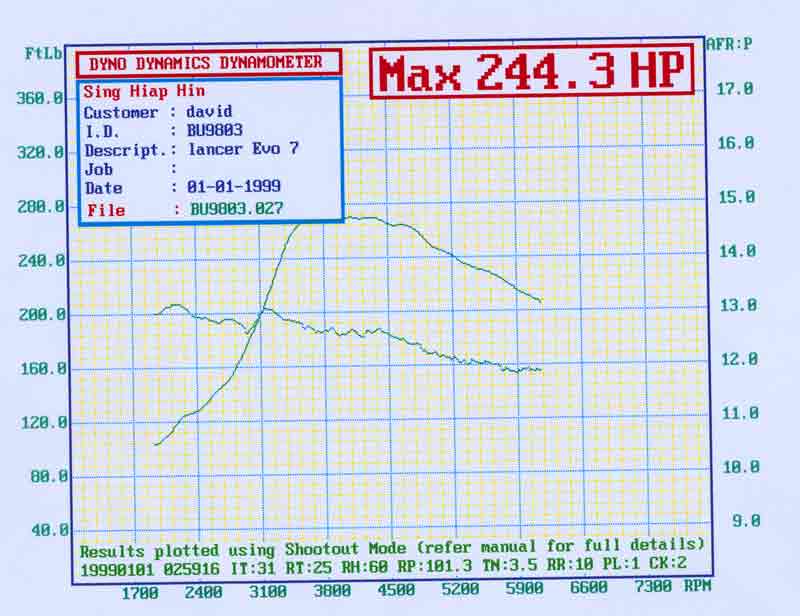

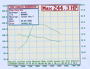

And torque..

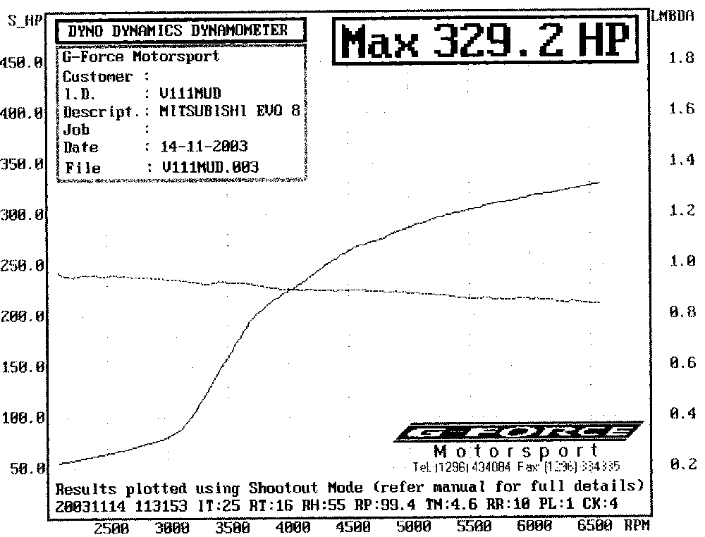

Mate my car is the FQ300 with a couple of mods I have done.
I do have that chart! and me car is running alittle lean. here it is buddy

Yeah that's running quite lean.... which ECU r u using? Piggyback or replacement?

Its the standard ECU my friend

Mud, do u know if your dyno run was running shootout mode 4 or 44? Running shoot 4 produces a much higher run than 44 coz 44 is for AWD cars... i got a read of 316 using my stock car with 3" catback... and airfilter... but 44 produced a more lower but more accurate read out... this may be something you may want to inquire into....

The dyno was done at a Mitsu specialist, who regularly do Evo rolling road days which are featured by magazines like Banzai etc...Its been said it is the most accurate rolling road in the UK. It was done as the 44 for AWD.
The FQ300 model is 305bhp in standard form. I am getting slighlty better figures than expected cos the car is running alittle lean due to removing the CAT pipe and replacing with the straight thru.
