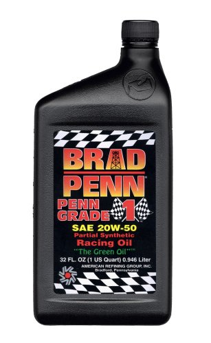

So today it was nice 60 degree weather and I finally got around to changing my leaky oil seals on the cooler lines and changed the oil. When I took the lines off, the oil coming out was like a long oil turd and very thick like jello. I then drained the oil in the pan and it too was very thick in spots. Very lumpy coming out of the pan. No metal shavings I could see but this oil definitely lost its ability to flow. Due to my race bearings, I'm running a thicker 20w-50 oil. I replaced it with Mobil 1 20w-50. Running E85 and maybe 1000 miles on that oil but it mostly sat over the winter in a garage.
Has anyone else had issues with Chunky or Lumpy oil? I've ran other brands with more miles before and never had this issue. Definitely has me concerned. I may send in an oil sample.
For now, I'm staying away from Brad Penn oil.

Haven't contacted Brad Penn yet. This is the first time I have ran BP oil. I guess its also known as sludge. The stuff in the lines was so thick I was afraid to start my car with the condition of the BP oil so didn't drain the oil warm. Maybe it has something to do with the lacking of antioxidants or something. When draining the oil from the pan, it would sometimes stop then come out in a clump. Tore apart the filter and found no shavings or anything to be alarmed about.

I run bradpenn, because my engine manufacture required(requested) it. Its likely just an oops on their end.
