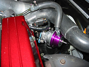

I got my BOV from the good ole brown truck today and just installed it. Do I need to cap that other inlet pipe or what? I'm not a mechanic and i appreciate the help. I noticed a nice difference when shifting gears. There is a little stutter when you first punch it but it definitely feels better than the stock BOV.

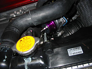

one more

the aluminum "plug" that you received is only for vent to atmosphere.. which looks to me like your recirc'ing, so you dont need it.

thanks for the replies........I'm glad I got it right.....i have the aluminum plug in the box with the stock bov.

kachur. Take out the smaller of the 2 springs in the BOV. That will fix the stutter problem
