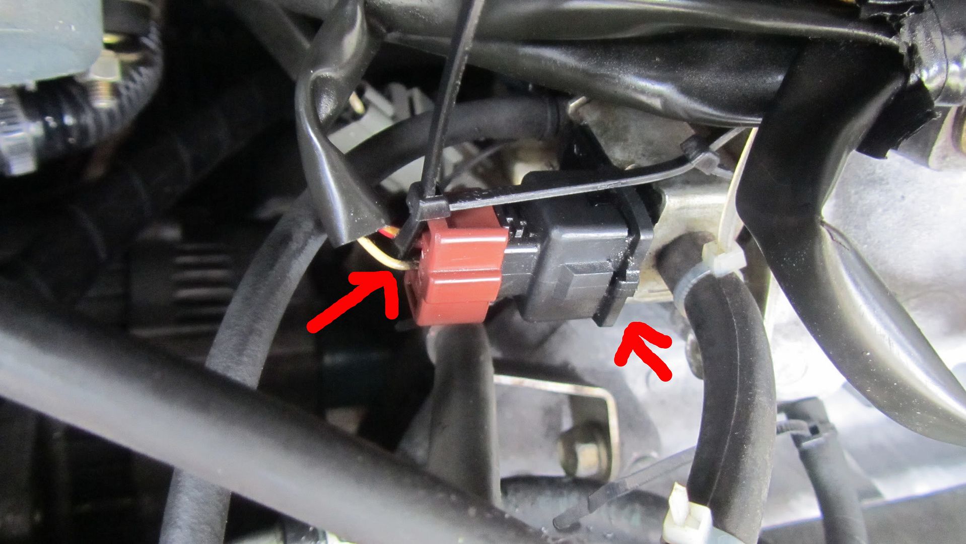

Ok so i think i found my problem I found a loose connector , I think it is the fuel pressure regulator solenoid but this connector was very loose and it wont clamp down or lock its self i tried pushing it on all the way not giving too much force but enough to be firm and it just seems like it doesn't even have a locking mechanism, so i took some zip ties and tied it on there and the car seems to run fine now however i haven't really tested it long enough but what is the deal behind these connectors are they supposed to actually lock or latch because i see the previous owner has zip tied many of the other connectors I took some pictures here is a couple pics if u could let me know what this goes to and if i can or should get a new connector appreciate all the help

hmm just started the car up fine then once it got almost fully warm it just died , then it had a hard time starting after a few tries it started back up died again and then i got it too start and run and parked it and i let it run for a few mins hmmm I wonder if some how the cam position sensor is messed up already or wasnt installed correct not sure or if it was something and is something else all together

Make sure your map sensor is still plugged in all the way, also I would take it off and check to make sure its not cracked (seen it happen before). Are you running a gm AIT or is your speed density set up run off of your fuel temp sensor? If its Gm AIT I would check to make sure its still working properly.

ya the map sensor is all plugged in looked at it and didnt see any cracks , not sure if its Gm AIT or not , its weird cause the car just started up fine again so now making it hard to figure out what is going on

Fixed once again we found out it was a faulty cam position sensor sometimes even new parts will fail so we got a new one from a different brand and car seems to run great : )
