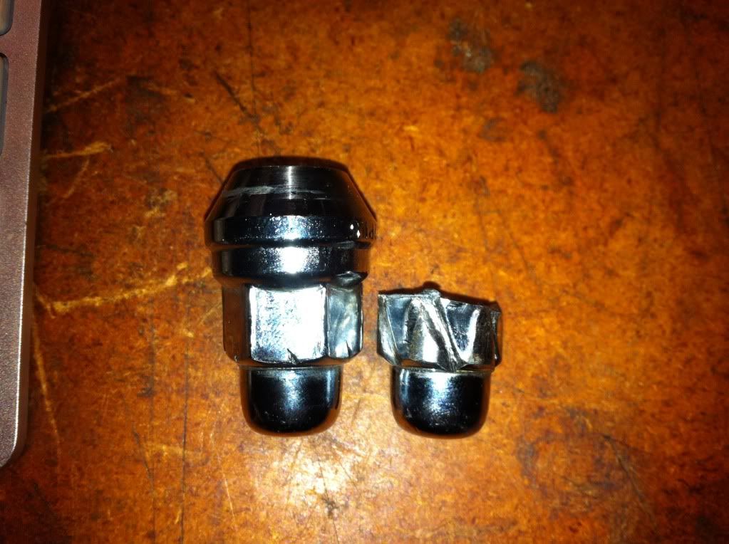

Can someone give me some advice, i snapped a lug nut in half and have no clue wat to do now...

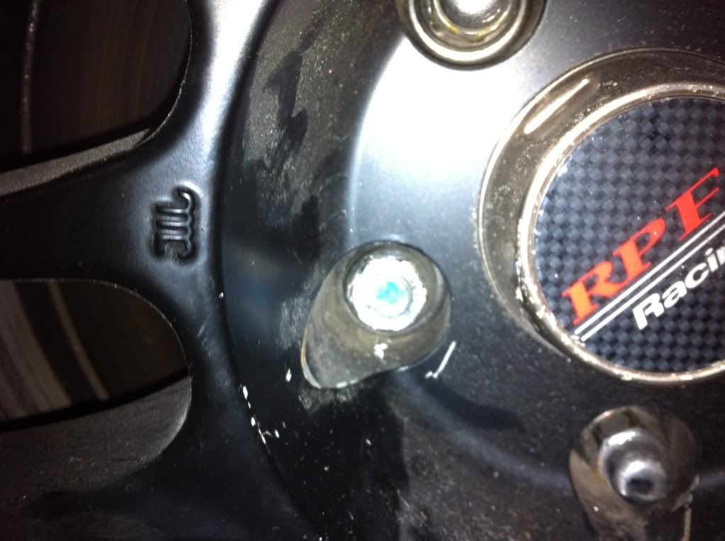

Im trying to save the rim if possible. Any one got any ideas? Its snapped off flush with the stud.

well theres no room to grab on anything if u see the first pic, i dont even care about this rim now i just want this thing off. im tryin to figure out some way to snap the stud or suttin.

the best way i know and what some shops do is hammer a socket on it and impact it out. u have to get one that DOESNT fit it, ie a smaller one and hammer it on. socket will be destroyed most of the time.
oh man, just re-looked at the pic, theres barely anything for the socket to grab on.

there is no lugnut left dude its just the tapered peice thats inside the rim

thats exactly how it snapped hammering on a socket and usin the impact theres nuttin left to put a socket on

Prob the safest thing to do is cut the back side of the stud off the hub. I had to do this in my talon once. It will save the rim but you will need to replace the stud think about what is cheaper.

do you even think theres space to do anything behind there?

Take all the rest of the lugs off first. Get it to that one is left and then you have to wack it with a hammer to see if you can break it off the hub in the back. Once it is free just use a matabo or something to cut the back of the stud off and it should come free from the hub. I will say this though BE PATIENT! I know it sucks and I really feel bad for you. It should work you just have to try to be gentle enough with it to not mess anything up. Another thing too is someone suggested tring to get a socket on there and get the rest of it out. I would try that first to see if it will come out. Hopefully you didn't crossthread it on there, but if so you may have to use some force to get it off. Good luck my man.
Edit: I just saw how you broke it. Yes your gonna have to just try to beat it loose now.

just looked u cant even see the back of the studs witout the dust sheild n rotors off

I've had to change a wheel stud on the evo; rotating the wheel so that the dust shield isn't in the way should give you enough room. Might want to remove the caliper to have more room to work.

i dont see how u remove the caliper with the wheel stuck on
