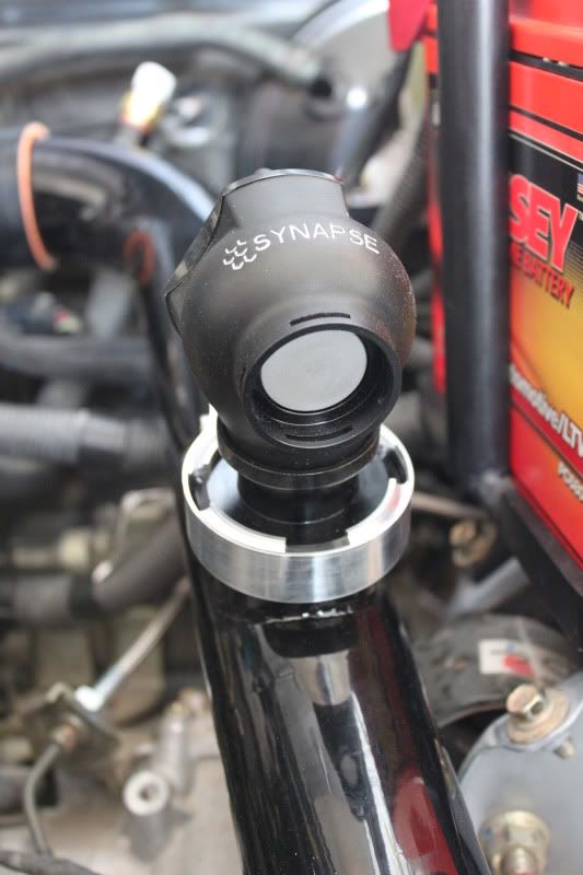

So I'm getting really close to completing my build and I've over looked on thing. I am setup to run speed density and I have a synapse recirculating bov. Can I vent this to atmosphere? I will eventually upgrade but right now I'd prefer not to.

Sure. Just run it without the recirc hose. I vent my Forge RS. Just watch which direction you decide to vent it.

If you are set up to run speed density then yes it's fine to VTA.

Yes. I am using a Tial adapter flange on mine!

Do you have the synapse valve in hand?.... because it tells you directly in the setup configurations table... the answer to your question. It can be ran virtually any way.
