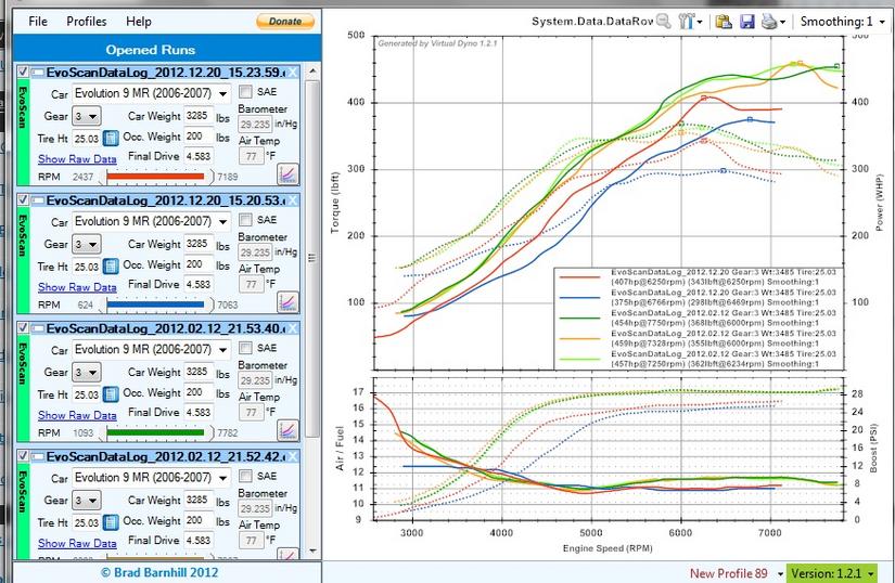

Here are the graphs in VD...the blue and red lines are after install...you can see how much its lagging.

In case anyone was following this I figured I would update you all on the progress. I finally figured it out. When I originally had the car tuned I had a turn down instead of an exhaust. I recently put my exhaust back on and even though its only a test pipe I guess it was restrictive enough to take 2 PSI away from me and slow the spooling process. Learn something knew every day!
