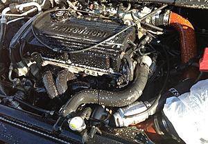

Photo for reference...so with the way my forge valve is installed (facing fan) its too close and almost practically touching the fan housing...i tried reversing the hose with the valve pointed towards mini battery but it hits the battery...how can I custome fit it?

how about shorten the hoses a little bit?what's that white stuff all over you engine?
Lol degreaser i was cleaning it
It wont reach if i cut them

Can you mount the blow off valve on the pipe and use the return hose to the intake?

If its the fan housing you are worried about then you should be fine but if its the blades of the fan you are worried about then get a longer coupler hose on the intake side and shorten the other hose on the charge side.

Originally Posted by ets michael
can you mount the blow off valve on the pipe and use the return hose to the intake?
+1

I had the same sort of issue. Like mentioned earlier I connected the BOV to the UICP and ran the return to the intake.
