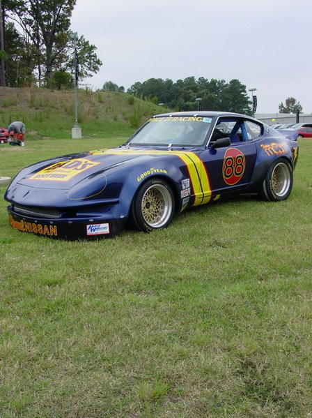

Having finished the last big car project 2 years ago and swearing it was the last, there's a feeling there needs to be a new project.
Fell in love with the EVO 8 when working at Mitsu for 2 years and have built a few 1st gen Datsun 240Z's included a 327 Scarab, but the Z suspension and brakes are sort of whimpy and it's only 2WD.
How about a IMSA bodied 240Z with an EVO 8 chassis/drivetrain? The 240Z weighs under 2400 lbs and you could trim even more with lighter seats and plexi windows. Thinking the drivetrain weight is about the same, as the Z engine is a 2400cc iron block straight six.
The Evo wheelbase is about 12" longer than the Z but that could be easily modded with a shortened drive shaft. The Evo chassis would be cut just above the lower door sills and welded to the Z at that general area. Any rigidity issues could be solved with a full roll cage. The cut might have to be further up, either that or just use the outer body panels of the Z and most of the Evo chassis.
There may be clearance issues with the height of the motor. Thinking that the Evo motor could be rotated backwards with a trans adapter plate, either that or some hood bulges. Another problem might also be the height of the front struts.
Would probably be affordable also as it would start with a near or totaled Evo and the Z's can be had as beaters.
Thoughts ideas?
If you were going to hybridize a vehicle and used an Evo chassis drive train what coupe body would you use?
It's not that the Evo isn't desirable just as it is but just want a coupe and an extensive project.

Chop an evo and shorten the wheel base to make a coupe. Please

That's a thought. Like chop the roof about 6" and lay the windshield down a few degrees. Try to fit a Lancer coupe door maybe. Tough to make it look good though, you have to channel it also. It would be a ton of body work when I want to lean more mechanical type stuff.
The STI 240Z route looks maybe possible, there are more of them around a Craigslist search certainly shows that. The front is going to be very tight though. Maybe have to go with a G-nose.
