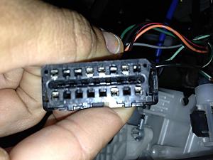

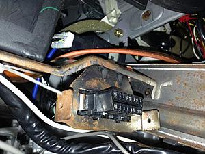

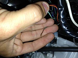

Well this is the Problem. I took my car to the shop to replace water pump, timing belt and some other stuff. The guy from the shop call me and told me that he couldn't tune the car because the white box next to the obd2 port(black) was missing. I think one or more pins are missing, there is a wire hanging around but no clue where it goes. So I need help in how to get one or what can I do to fix it.
I got some photos.

The wire thats hanging likely held the pin that was in the white plug in section which youre currently missing. Funny enough that one wire is literally the wire to flash the whole ECU.
You just need to get the white section from Mitsu and then resolder a pin to the hanging wire and get it in the right slot. I can try to get a pic tomorrow of its location.

Or just buy your own tactrix cable and cut the connector off and just solder 2 butt connector on both sides and you are good or find a junk evo and remove the connector from it.
