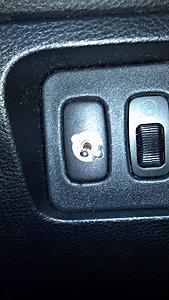

Which is in close proximity to a toggle switch that was first claimed it was there when he bought the car...then tells me he had some led lights after confronting him about this.
toggle switch just above harness
