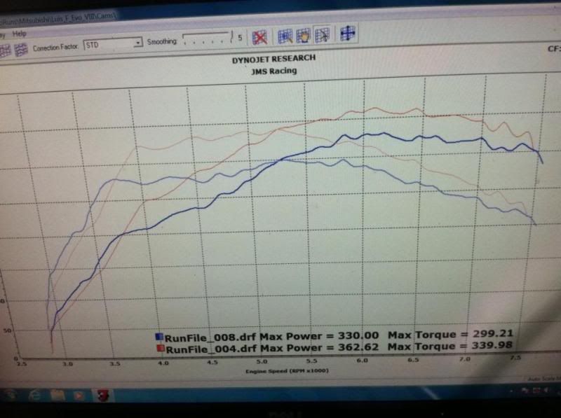

im from eagle pass, texas. Im using 93oct not 91. Ill post up my dyno graph, if you are doubting.

this wasnt the final graph..25psi 93oct

330hp was before i put the ETS 4" bfmic, licp, gsc cams
