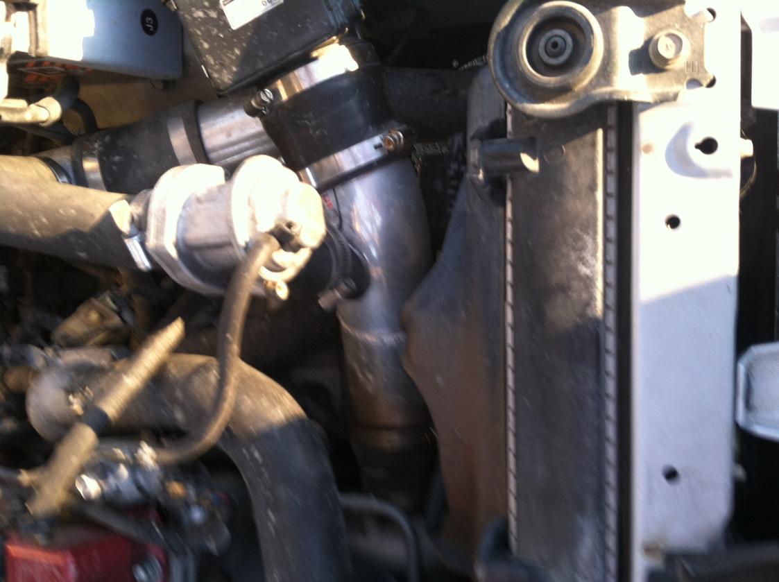

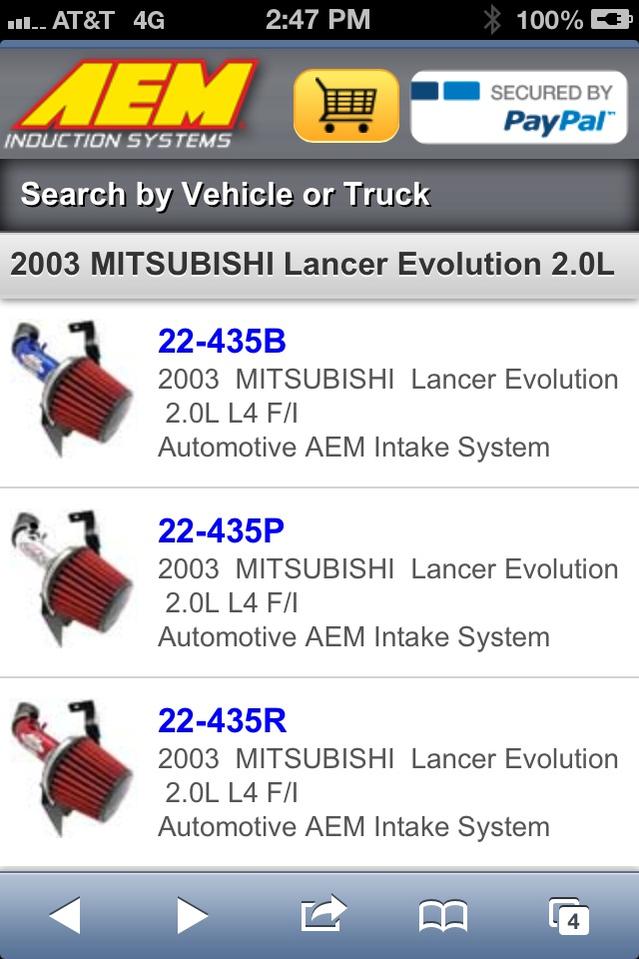

Post a pic so we can see what you're working with. You can also go to the AEM website & see if the model you have on yours matches up.

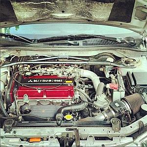

Here is the engine bay, I can get a better pic tonight when I'm home thats just one I had on my PC at work.
It doesn't have the heat shield thing at all.

Well yours is an '03 & mines a '05 so there's going to be some differences, but when you get home see if you can find a part number & post up what you can.

Your DV is on backwards too judging by the pic. Bottom port needs to go to the UICP side port to Intake.
Old Feb 21, 2014 | 04:04 PM
APEXR's Avatar
Joined: May 2010
Posts: 230
From: PDX
^ I can't believe I missed that.

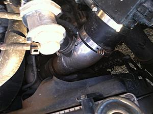

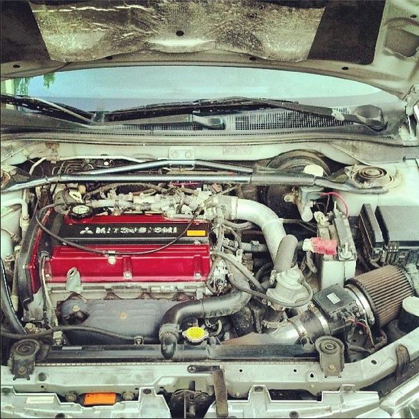

you sure the dv is backwards? cause when I put it the other way it makes that high pitched fluttering noise. I think thats an old pic and I changed it cause in the pics below its the other way. which were yesterday lol.

Yes the pics below are correct and differ from above.
