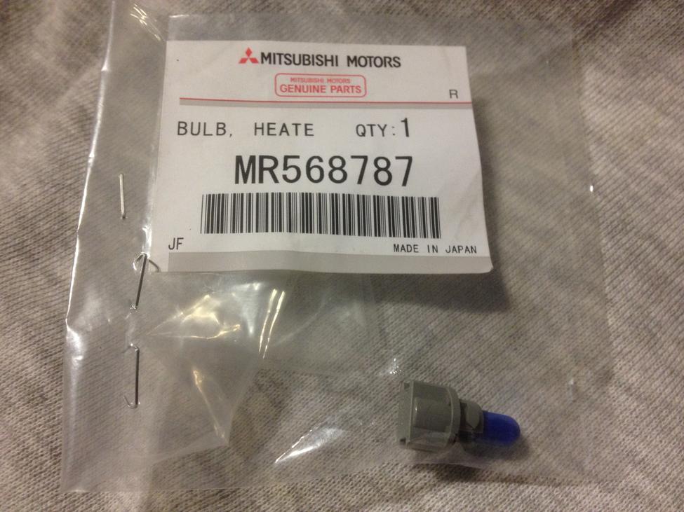

Does anyone have an actual number for these? I've been searching and I've found T10 but there is so many different variants of T10 not sure which one is which. Trying to upgrade them to LED so I can see it a little better.

I'm not sure what T-variant it would equate to but the Mitsubishi part numer is MR568787, ask me how I know?

Awesome! Thank you maybe I can cross reference it some how.
