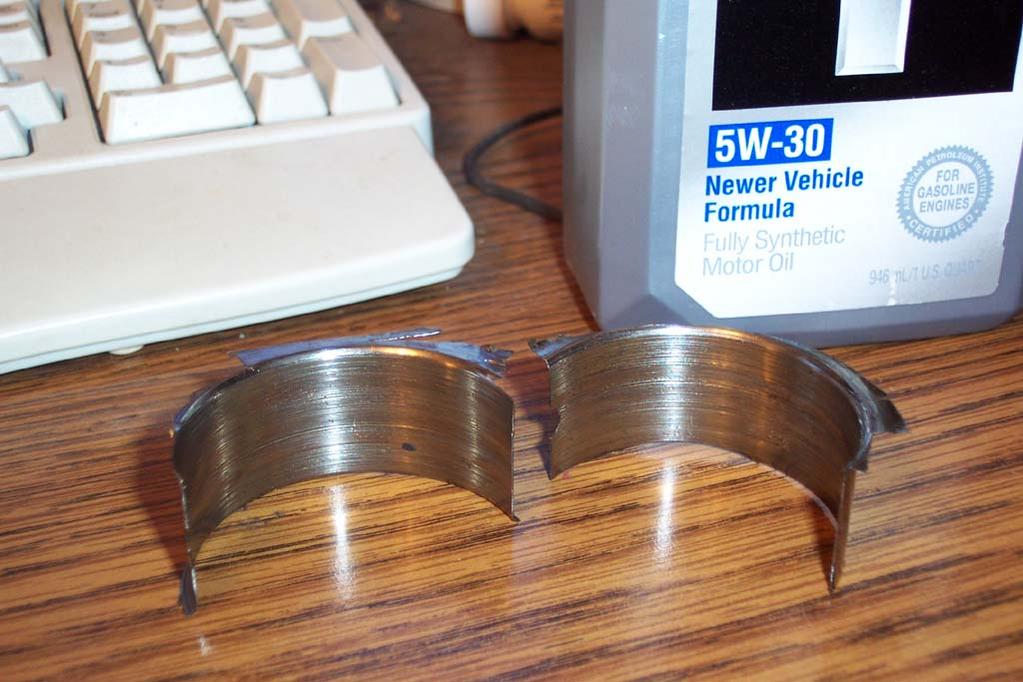

Originally Posted by ExViTermini
good lord how long did he drive it with it knocking?!?!? Thats the worst I've seen yet...
You haven't seen much then
LOL SMH

Likes: 13
From: Virginia
The last one I took apart beat and banged enough that the entire bearing was gone, the circlip came out of the piston and the wrist pin was digging into the cylinder wall.
And it still wasn't as black as that lol
