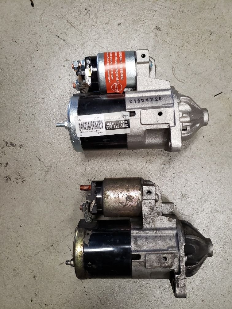

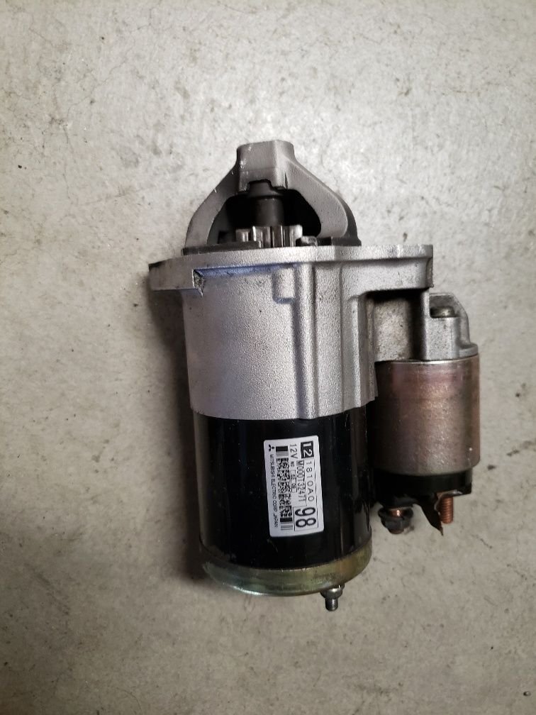

I'm here to clear up some of the confusion in this thread, provide some useful information, and prove the OP is over reacting over the wrong part. I also want people to feel more confident in buying some of these OE equivalent parts for the evo. As one of the biggest OEM fan boys out there I know it feels good to have a true factory part, however, I don't think it's fair that parts like starters, alternators, batteries, and accessory belts need to stay OEM. Spend money where you should and save where you can. I.E. Stick with the oem oil pump front cover because you can't afford to experiment in that area.

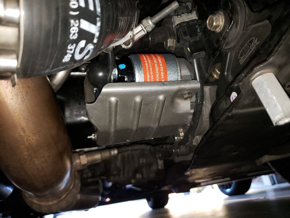

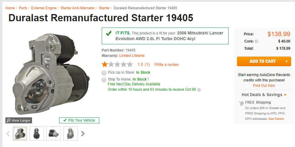

I just installed an Autozone re-manufactured starter (part # 19405) and it bolted up to the transmission perfectly. It has a 1 star review on their website from some donkey who claims that it is defective and of low quality. I needed to see for myself. It comes with a limited lifetime warranty and the factory shield DOES fit. The two studs on the back of the starter motor that pass through two of the four holes on the heat shield don't have the same thread pitch as the tiny 8mm nuts that come off the factory starter, but the holes for the 8mm bolts do have the proper thread pitch. I also bent the metal spade connector upwards towards the ignition wire for more clearance from my larger downpipe. This step is optional. It has only been a few days, but if this Duralast starter ever fails, I will report back here to talk ****. I don't think i'll be back.

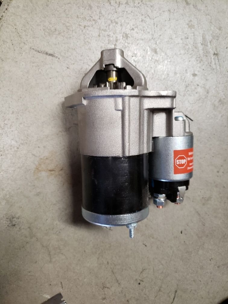

ebay "no-core" ones i tried works well too
https://www.ebay.com/itm/Starter-Mot...72.m2749.l2649
