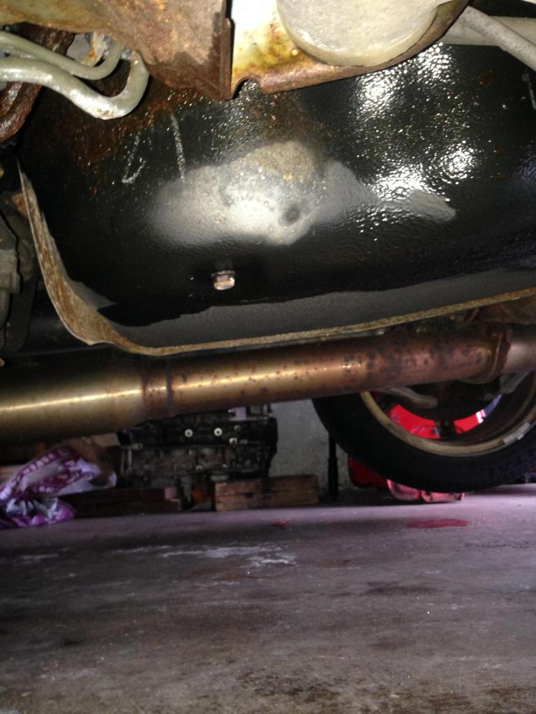

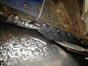

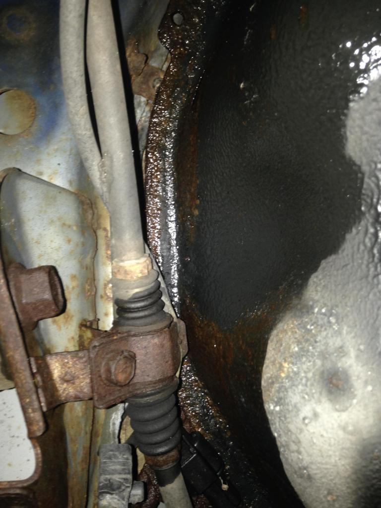

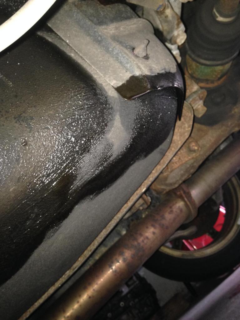

This morning I wake up with the smell of gasoline in the house, and go out to the garage to find that there is a good sized puddle of gasoline right next to the inside of the drivers side rear tire. I looked underneath the car and noticed the side of the gas tank facing me is covered with gas as well. I tried to look up further but really can not pinpoint where this leak may be originating from. I'll go back outside and take some pictures to add here if it may help.

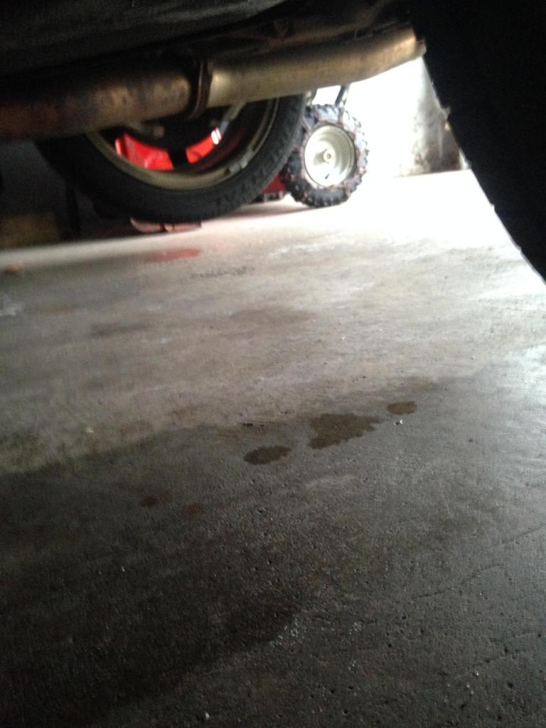

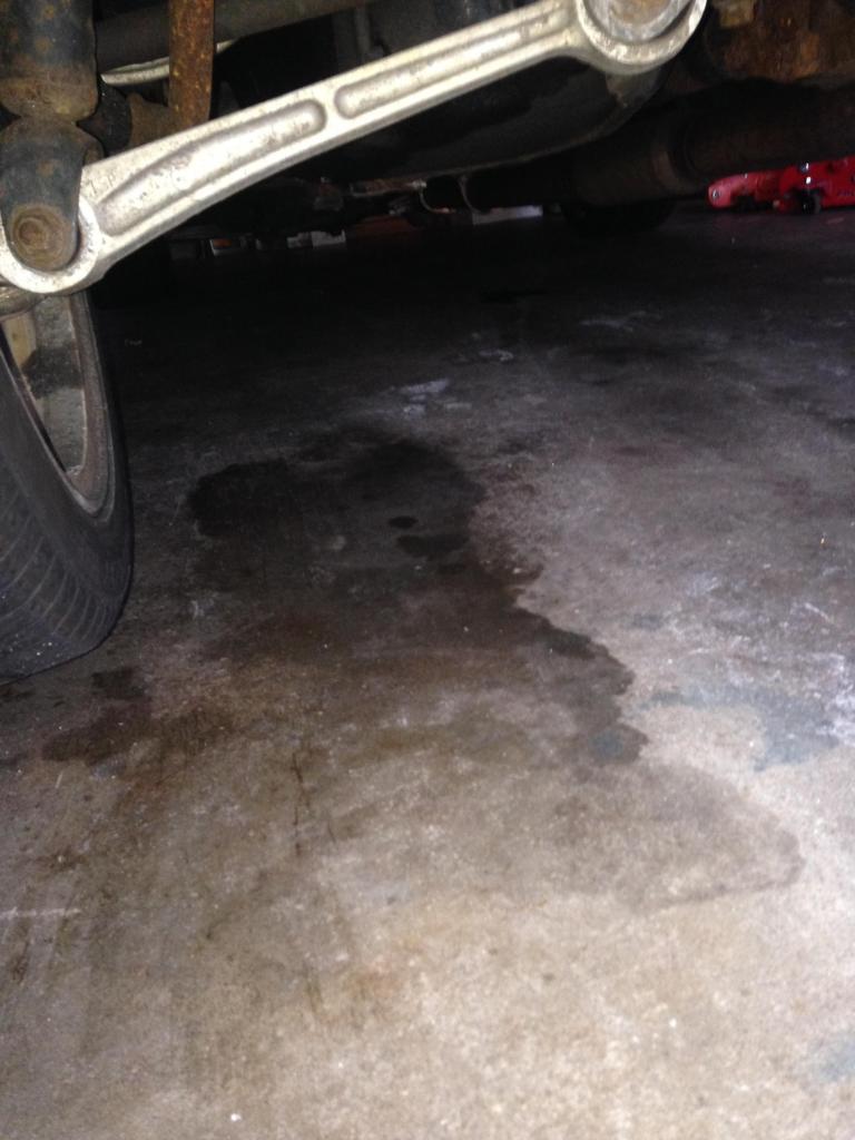

Size of the puddle after I wiped it up
New drips already forming maybe ten minutes after wiping up the original mess

Don't top off, gas expands.
Given the chain of events, I would withhold judgment until you run it down a little (or siphon it out, whatever) and see if it still leaks with a normal fill.
Given the leak fault, it is entirely possible you have a tank leak and over filling forced it out that way... but when you fill it beyond capacity all bets are off.

Thanks for the reply! I drove it around today and now it's been parked for a few hours and hasn't leaked a drop... looks like I need to drop the tank this weekend and do some resealing.

Check the bolts that hold the fuel pump in the tank. I had a leak and it turned out, when I took off the back seat and the cover, the fuel bump was missing a bolt that held it in the tank was missing a nut causing a leak when the car was near full.

I agree with rjfg, pull the back seat and check the cover. Also, check the line and make sure it's not loose or damaged. A lot easier and faster than dropping the tank.
