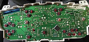

Hi Guys, I'm planing to replace my all my cluster light with LED, I think they are all once size.
If they are the same size should I use:
PC74 LED Bulb
https://www.superbrightleds.com/more...panel-led/709/
OR
NEOx LED Bulb - High Power
https://www.superbrightleds.com/more...-led/221/1007/
If the NEO buld which size 3, 4 or 5mm?
I have taken a pic of my cluster and trying to list what each bulb do (see attached)
Do I need to get a matching color with the filters (e.g. green for turn indicator and inter cooler spray) or can i gust get bright white? currently they have the warm white fitments built in them.
Below is a list of what each bulb is lighting up, please feel free to correct and fill in the blanks, I hope this thread will help others doing the same thing.
A - Side / Head lamp
B - Right idicator
C - Rear fog light
D - Left Idicatior
E - High beam
F - Front fog light
G - Intercooler
H - Set Belt
I
J - dash back light speedo side
K - dash back light middle
L - dash back light feul gauge side
M - Battery
N - ABS
O - Hand break
P - Oil
Q - Check Engine
R -
S - ODO back light
T - SRS
U -
V -
W - Door Open
X -
Attached Thumbnails Cluster lights replacemnmet-dash-backlights1.jpg   Cluster lights replacemnmet-evo-dash-side-b.jpg

J K L are going to hot-spot really bad. don't replace those with LED's unless you get REALLY NICE 360* ones
I'd keep the stock ones

I would not do it. I hate it. I did mine and just full of regrets. It looks nice, but it's just overkill. The 3 main lights are LEDs, L/R arrows, and check engine light. The light spread sucks. I got my lights from eBay and super bright LEDs.

FWIW, I used these as the main bulb for lighting the cluster and it is fairly even. There's a tiiiiny bit of hotspotting on the left most cluster (speedo) but IMHO still a massive improvement over stock:
https://www.superbrightleds.com/more...l-led/221/995/
(the 5mm in red)

Do they all use 5mm holder? which will be better using the original holder with 5mm LED (200 degree wide) or 1 SMD LED for the warning lights not for the main back lights? For main lights I will get 360 degree wide spread LEDs.
Cheers
Finally, I end up doing mine as well, went with RED SMD Neo Wedge. picture attached above
