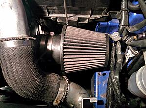

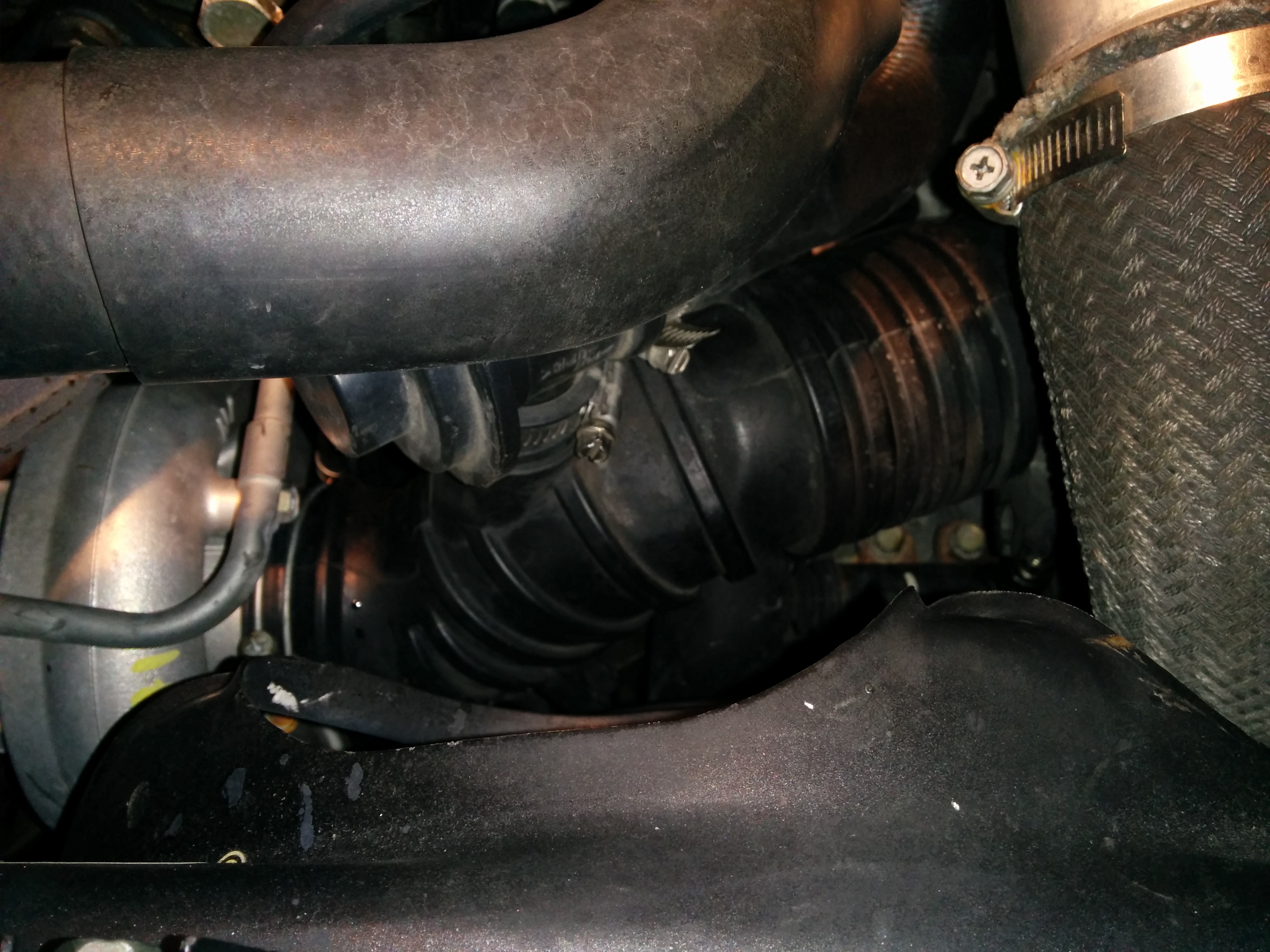

Hi everyone. I'm new to the forums and a new Evo IX owner.

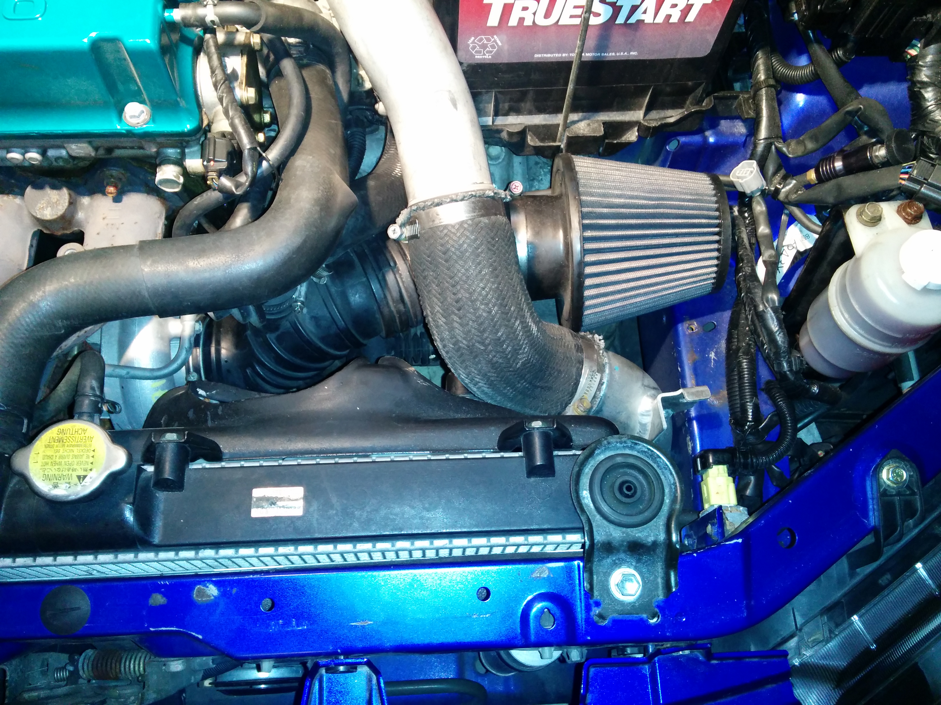

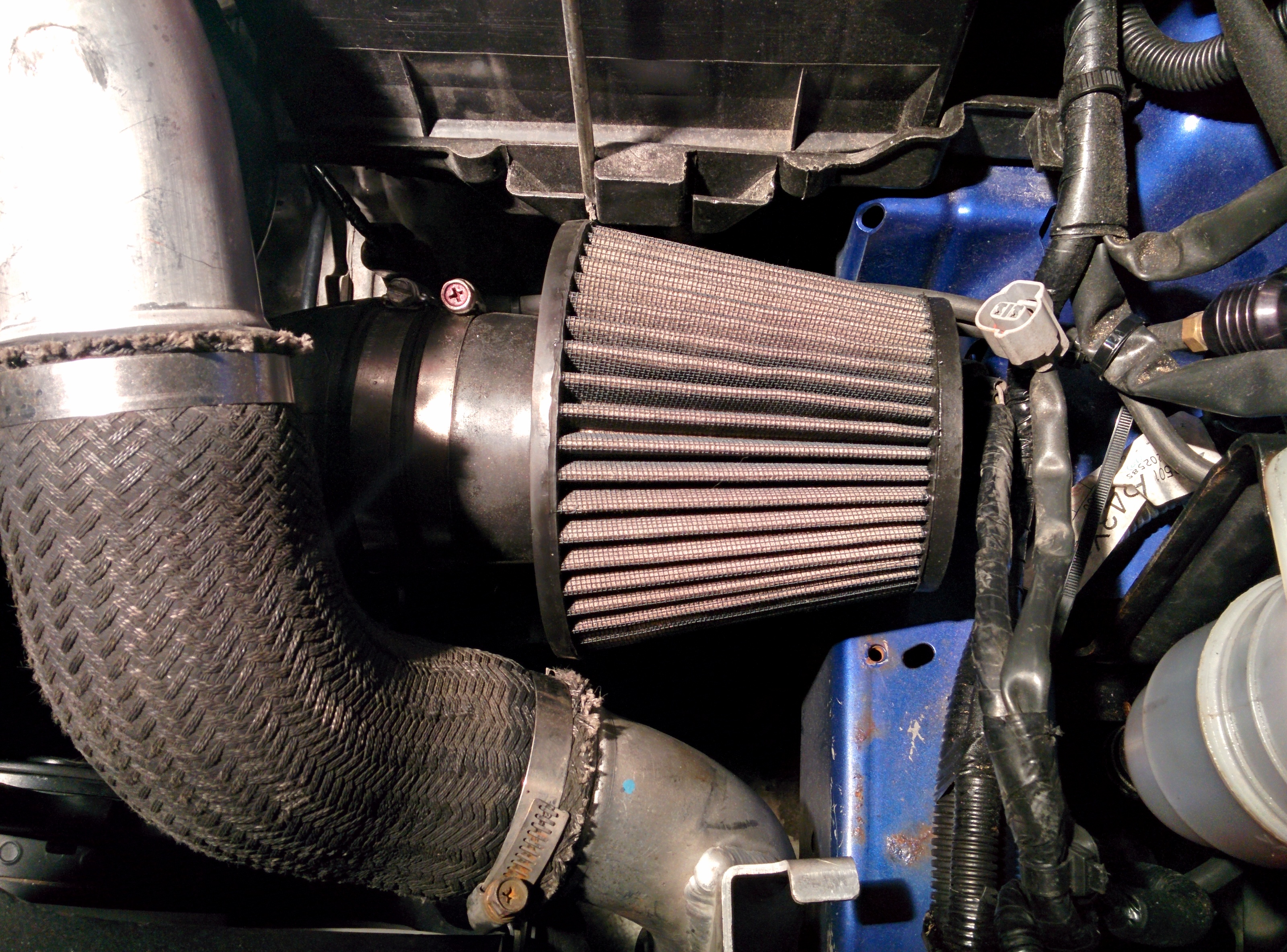

I was looking at my air intake setup and it looks like the MAF is removed. From reading a bit, it looks like that's meant for a Speed Density setup, which I'm not running. The car is pretty much stock and it might have had mods that were removed before I purchased it.
My question is, should I pick up a replacement MAF and will I also need anything to make sure it can connect to this air intake?
Thanks!

If you car is running fine as is, then don't mess with it. It already has necessary parts to bypass the MAF.

Ok great, I'll hold off on doing anything. Just wanted to check because I had a mechanic ask me about it. The car seems to run well enough, but I don't have another point of reference since this is my first evo. I'll probably have a better idea once I take it in for a tune.

Yeah, you may be tuned on speed density. Try and look if you have an upgraded MAP sensor and a IAT sensor. If you find those then your car is already tuned for it. Otherwise, you should be staying out of boost until tune. I'd suggest you not to buy a MAF but to buy a 4bar map sensor and get it tuned for speed density if you're willing to mod your evo!

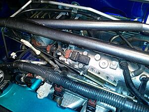

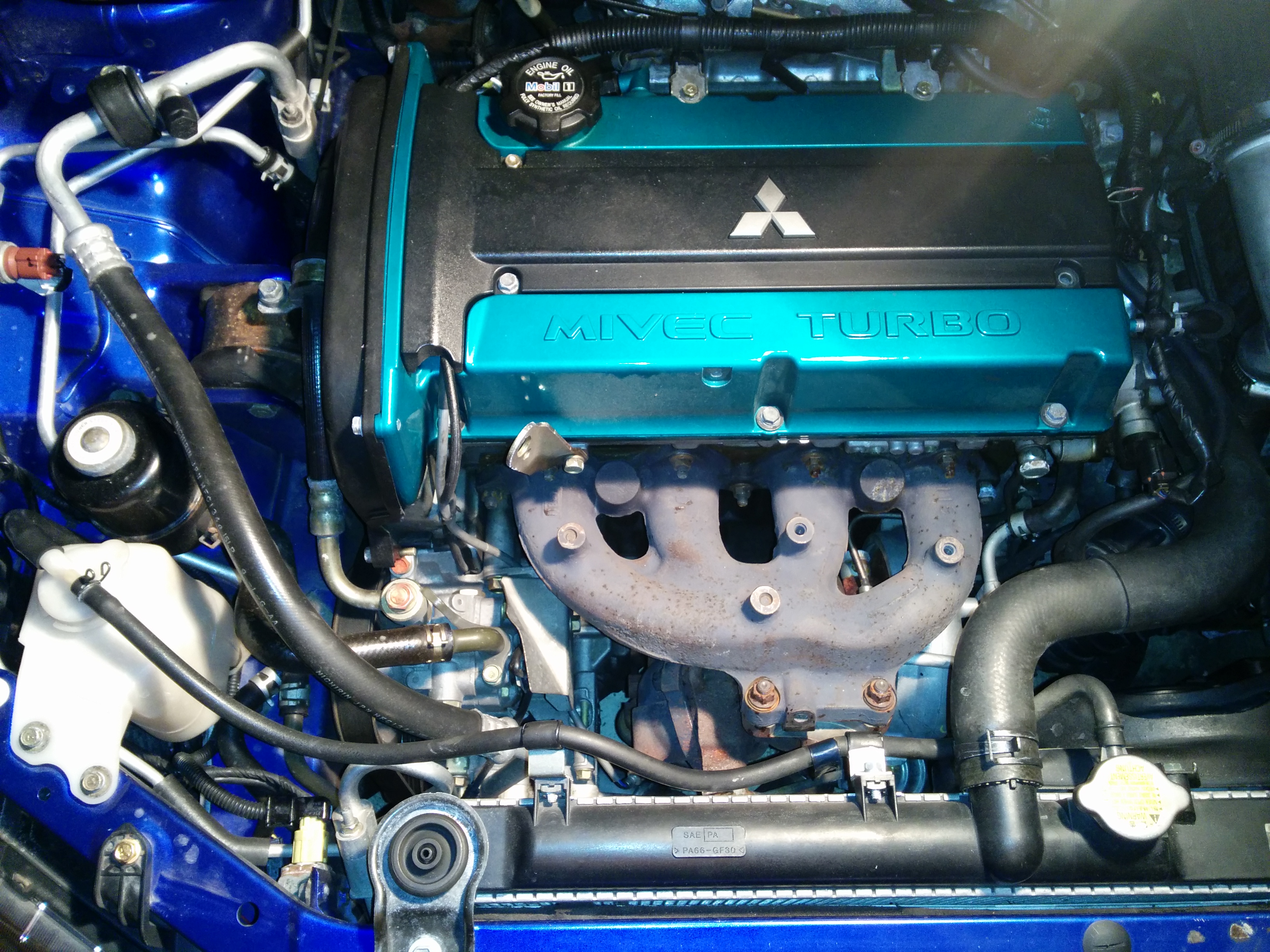

Ok that's what I thought about being speed density. So I really need to take it in and get it tuned. I didn't see any sensor on the manifold. Here is a picture of it to double check in case my eyes missed it.
So I need to pick up this part (http://www.maperformance.com/omnipow...evo-evo-x.html) and not install it until right before the tune, correct?

Still can't see it cause no intake manifold in the picture lol intake manifold is the aluminum piece right under the strut bar.you already got this sensor if you run without maf my friend.you are tuned already I see manual boost controller.

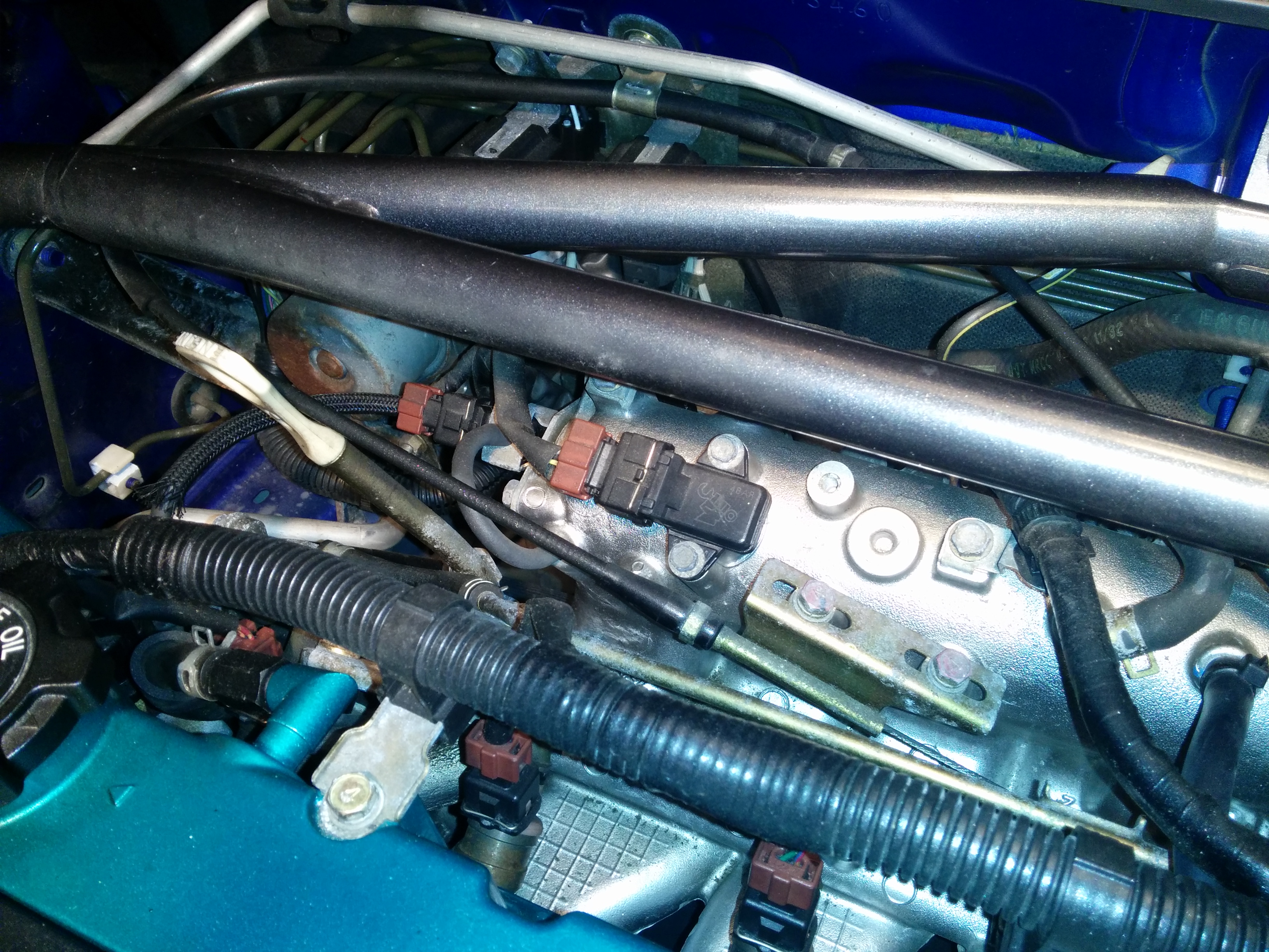

haha, oh man, I'm a total noob at this. The front part is just the exhaust manifold and the intake manifold comes in behind. Got them mixed up...
In either case, I found the 4bar sensor right where you said it would be:
Thanks for the help! I guess I'm good to go.
