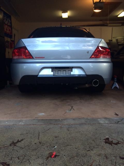

Old Nov 12, 2015 | 06:31 AM
domenictoretto's Avatar
Joined: Mar 2014
Posts: 50
Likes: 8
From: Charlotte, NC
Originally Posted by Kada__85
It'll work, but will stick out a bit. My buschur bullet exhaust stuck out a couple inches past my jdm rear and worked percectly until I bought the buschur sd muffler made for the jdm rear
x2 - Just did the exact same thing as well. Pics for reference below:
Bullet for USDM:
SD for JDM:
