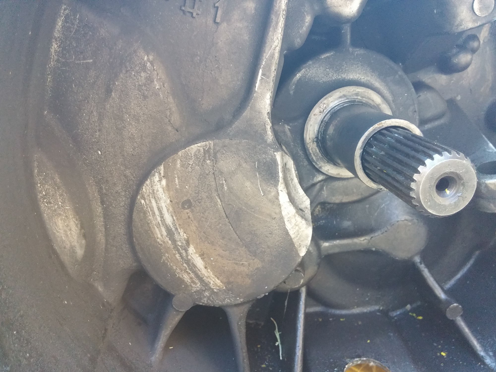

Any chance of it being the throwout bearing? Also, when I pulled my old trans, I noticed the case had rubbing on it, I assume from the clutch coming out too far. Pic:
