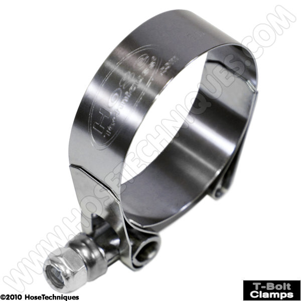

I use all Hose Techniques T-clamps & silicone hose couplings on my IC pipes
http://hosetechniques.com/index.php?...oducts_id=2078
They are very generic & some clamps are better than others. So shop around.
