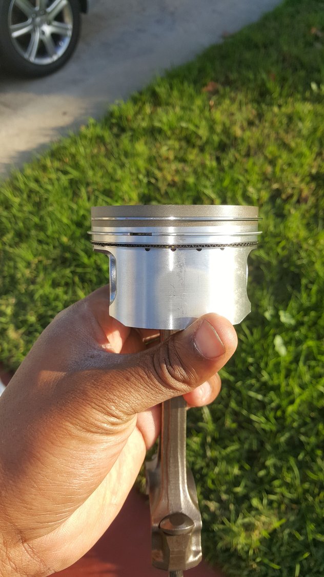

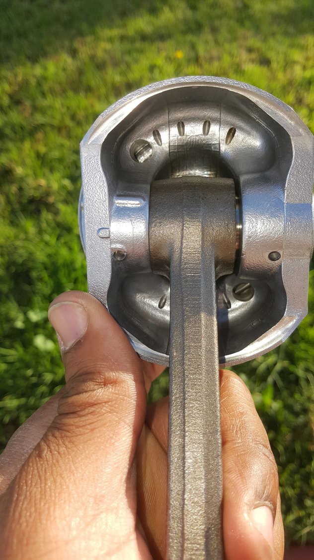

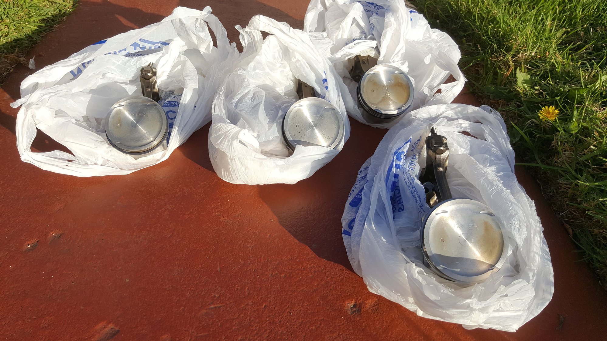

Old Jan 6, 2017 | 03:44 PM
  #42
lonestarr20's Avatar
Joined: Jan 2015
Posts: 250
Likes: 15
From: Hub City
Here they are
