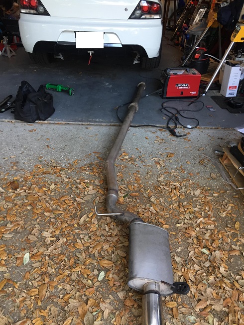

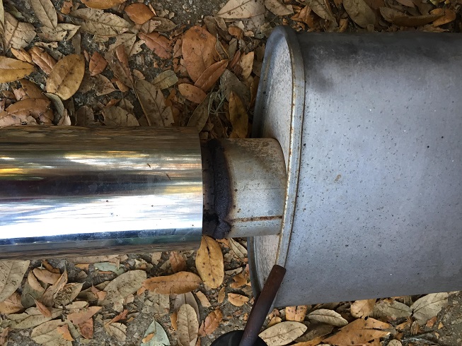

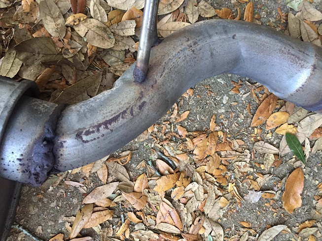

awesome thx man...havent had a chance to log the fuel trims...tomorrow im taking my kid to universal for his birthday so maybe when i get back ill log it...now i have to try and find a muffler...look at what the previous owner did...im thinking buschur sd maybe?
Attached Thumbnails fuel pump issues?-img_4052.jpg   fuel pump issues?-img_4051.jpg   fuel pump issues?-img_4050.jpg
Those are really nice welds, they look like my coworker stevens work!
