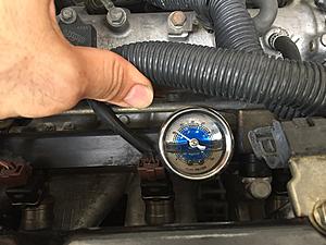

Ok so i just got home and it's hot over here...was in bumper to bumper traffic...I was merging onto a road and cars were coming so I had to get on it in 2nd..after that in traffic the car started idling lean from 15.7 - 16.8 all over...car drove fine but it was doing this...I get home and right away popped the hood and check fuel pressure with vacuum hose and without...also took a pic of what the pressure did when I shut the car off...dropped to 30 ish and stayed there...
1st picture is with vacuum line on - right under 40psi
2nd picture is with vacuum hose off and my finger over it - needle between 40 and 50 psi
3rd picture is after shutting off the car - dropped to right on top of 30 and stayed there
4th picture shows how my vacuum lines are routed just in case there's something wrong
no I did not paint my nails in my 2nd pic that's my wife taking the pic while I hold the vacuum hose...lmk what you guys think...

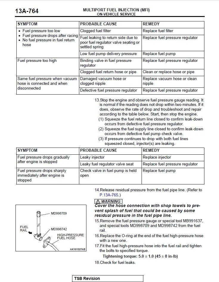

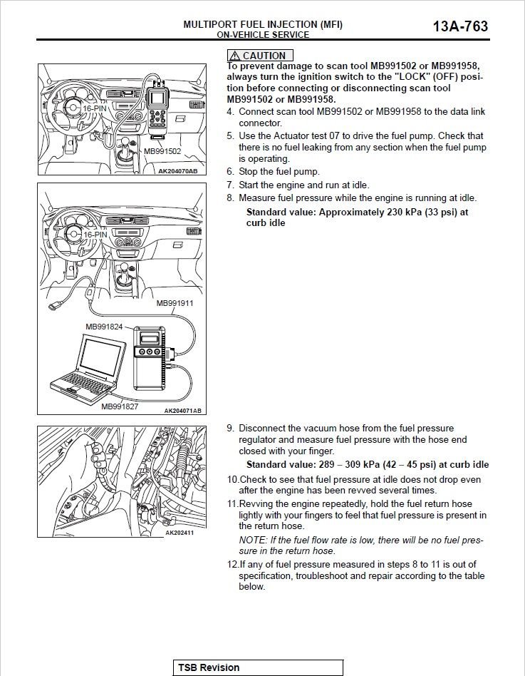

Old Apr 4, 2017 | 03:13 PM
  #40
Biggiesacks's Avatar
Posts: 5,690
Likes: 708
From: West Coast
there are the steps to trouble shoot fuel pressure issues. You saying the pressure drops when you shut the car off does conflict with what those pages say. Shouldn't drop for a couple minutes. So i would try following the steps and see what you turn up.
