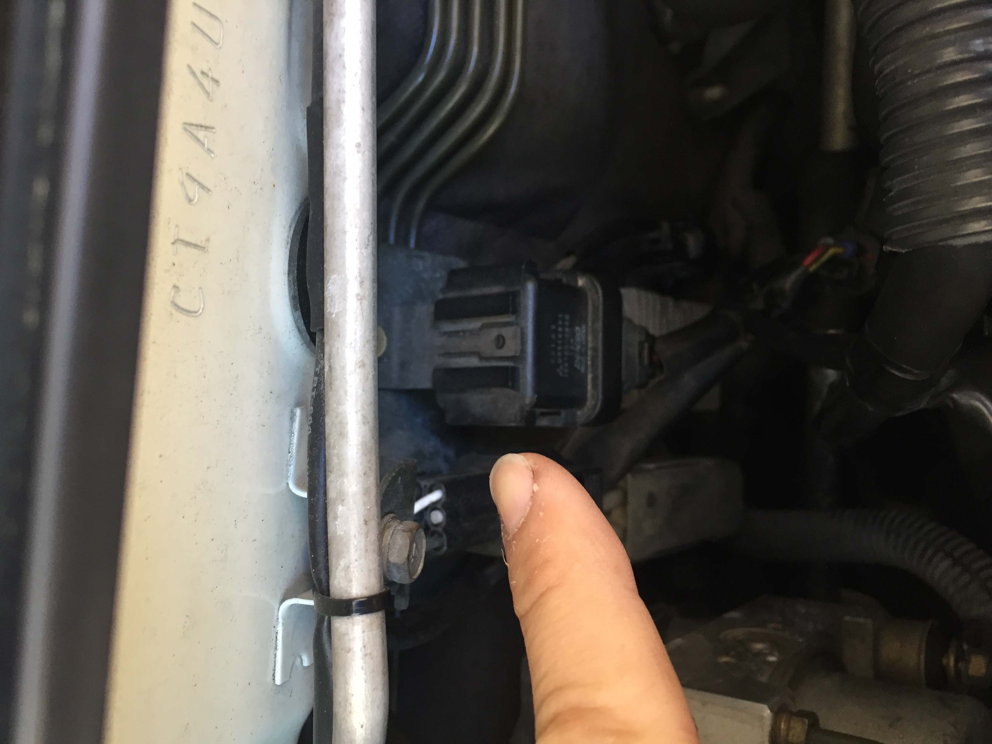

So disconnect the resistor and check the fuel pressure? Is this safe running the car without it? Once again, not too great with electricity. I replaced fpr and solenoid yesterday since I got it so cheap and it looked new. Went out and did a couple pills keeping an eye on afr with a friend. This was at 6 something pm so it was fresh out. Car didn't go lean at idle after but the times it has done this it has been really hot out like mid day. I have a cable and evoscan just gotta figure out how to log fuel trims and post it here...
This is the relay correct?

#3 relay sticking could be a possibility. Again though fuel regulator over run would cause a rich condition, not a lean one. Let me break that down, more fuel pressure means more fuel sprays out of the injector for a given Injector pulse width = richer fuel mixture. One thing we need to see to get a better idea of whats going on in the ECU are long term fuel trims.
First things first... make absolutely sure your plugs are good, I would throw a new set in. If you have a plug going bad it will totally mess with the fuel trims.
Yes that's the relay. Unplug it and see if it screws up. You can drive around with the relay removed but DO NOT hit any boost!
You can also remove it and check fuel pressure, probably should do that first.
