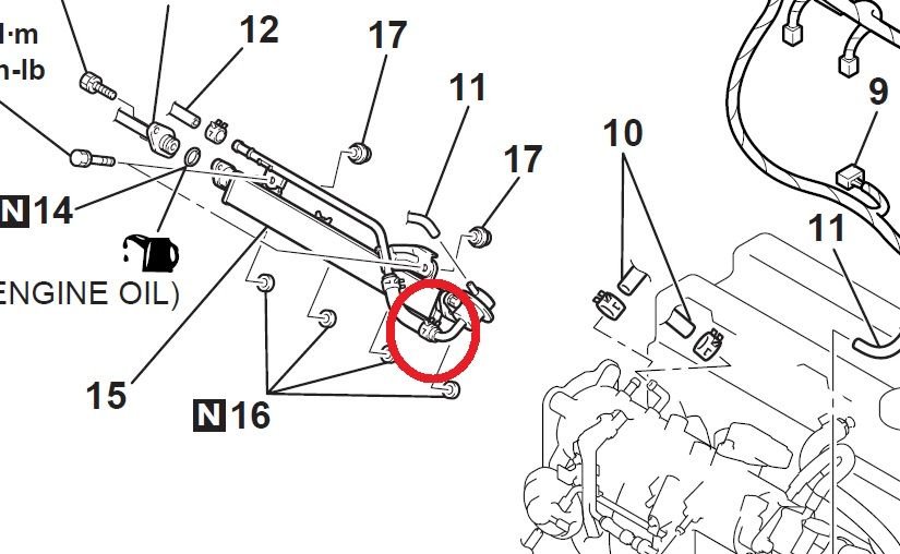

not that i really think this is a problem, but it never hurts to eliminate something as a potential issue, you don't need to T in a pressure gauge. Just unhook this line circled in Red and run a new line from the regulator to a gas can, or 2 liter coke bottle or something and start the car. If your pressure goes down, you have some kind of an obstruction, if nothing changes your return is all good.
That's how you flow test the pump.........after you've done it, you'll know the flow rate in litres per hour to compare against the specs (always less than advertised).
It's handy because it eliminates the pump syphon.
But you'll find that the pressure is still too high because the main culprit is the FPR which can't handle the extra flow.
As has already been said, you might figure it out in a couple of months.
These cars are all the same, do the same mods, they fail in the same way.
It makes a big joke out of the "how tos / installations" section.

Listen man, I'm not second guessing anybody. As I said before, I appreciate the help but take it easy. I must have missed the part about disconnecting the resistor and seeing if the car ran. I thought you meant disconnect the relay. I will try to disconnect the resistor and see if it runs. I will also disconnect the return and run a line to a gas tank and see if pressure changes. If this issue was ongoing when I had the car tuned and I didn't catch it because I had no gauge on there, I probably would need to retune if I fix this right?

ok I put a hose to the fpr and put it to a gas tank...pressure still the same so nothing wrong with the return line...i wish someone on here with stock fpr, aftermarket fuel rail with gauge on it, and walbro 255 would get on here and tell us what their gauge reads and whether it does the same or not...
