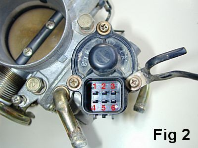

Can anyone tell me if the speed idle sensor on an Evolution 8 is easy to renew and its location please ?

Yes it is easy to replace. Remove 3 screws, unclip the wire connector, done. It is located on the throttle body.

Should be on the bottom of the throttle body, take the intake hose off to get to it.
