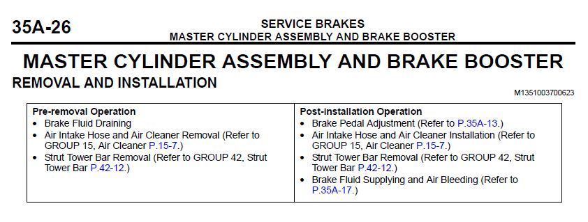

The FSM shows brake lines being disconnected at the master for booster replacement. From what I've read getting that air back out is slightly more work than clutch changing. Are you sure the check valve, which is in the hose, is working?
Old Apr 8, 2017 | 07:43 PM
I stand corrected! =)
Heres a clip from the manual noting the system must be drained before removing the MS (who knows, maybe members who have done this have not needed to drain the brake fluid)
I didn't know either until OP asked the question and I looked.
I've never had to touch the master on any Mitsubishi I've owned. I only know of posts on the Tires Wheels and Brakes section where people have seemingly run gallons through the system and still have a soft pedal. Somebody out there has got to know how to get the brakes up and going without all of this fuss.
In the meantime I think it would be worth it to spend another day just checking everything else on the system before breaking out the flare wrenches.
