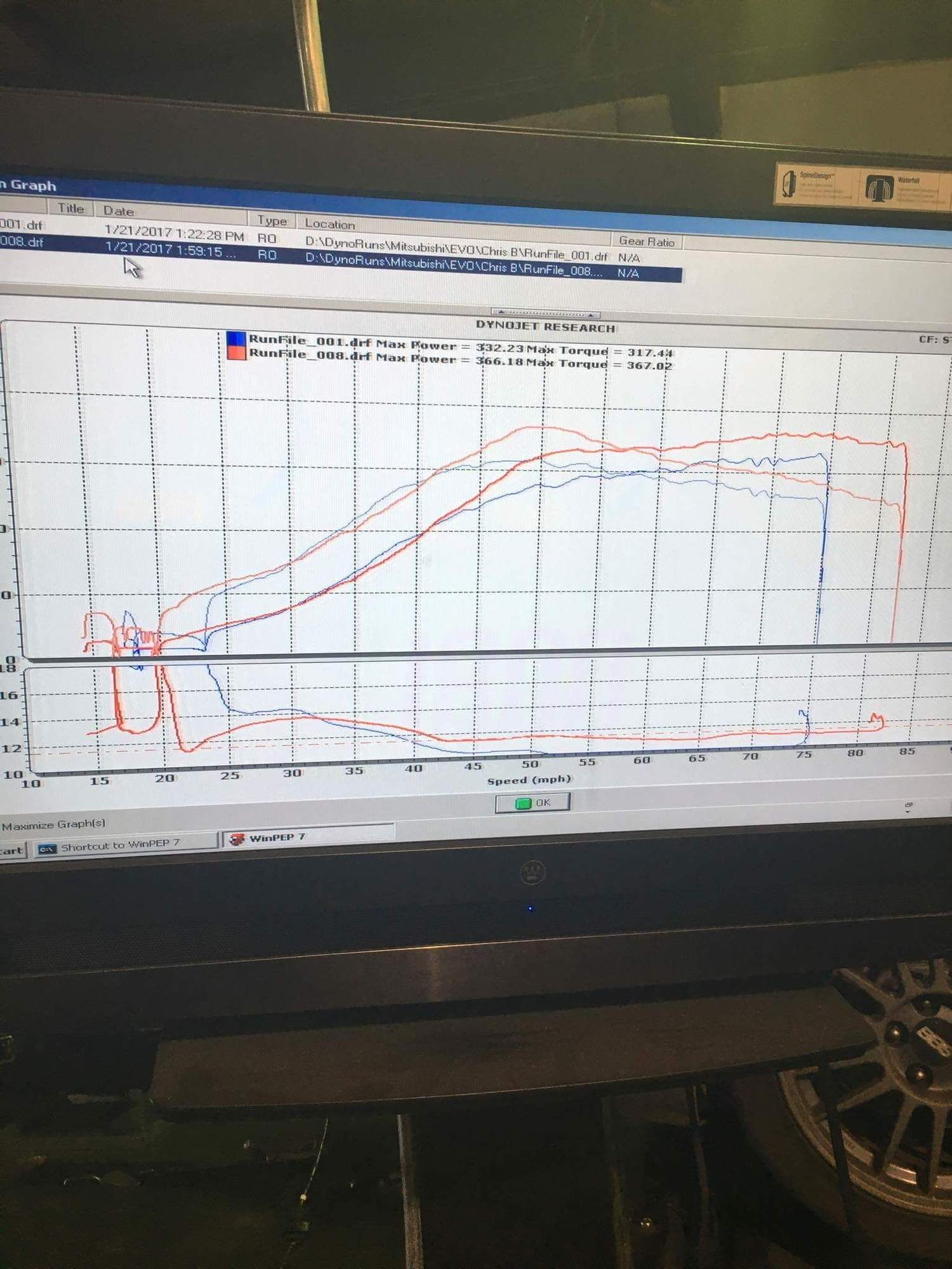

I was actually off a few numbers lol.
But here's the dyno run.
93 oct.

I was talking about my build its on e85.
