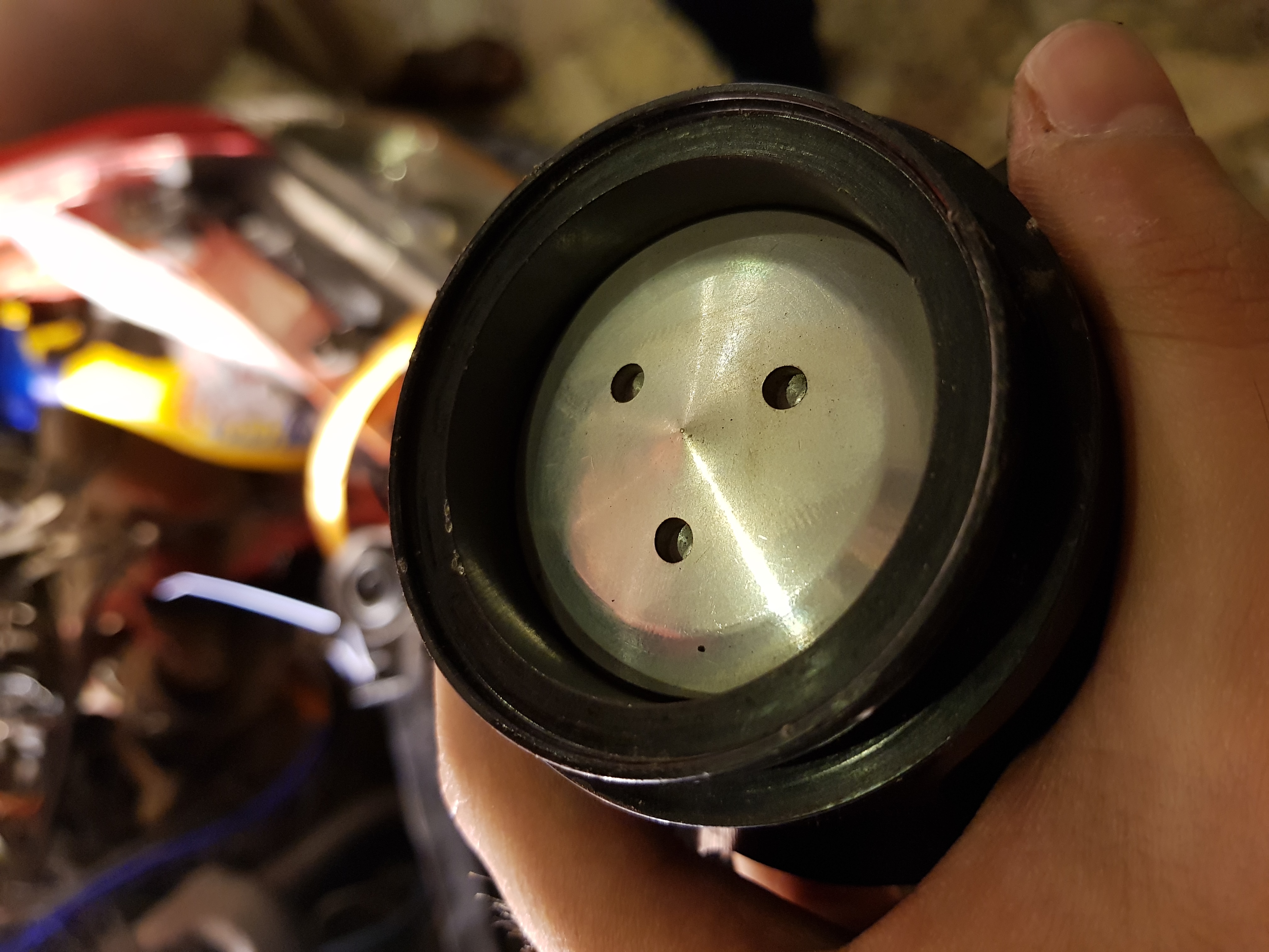

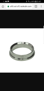

I have a tial BOV, and today I did a boost leak test..the BOV was leaking alot, when I opened it i noticed there is no ring inside like there is in my tial wastegate..is there supposed to be a ring or not? If you see the right picture of the ring thats what im talking about,my wastegate has that ring but the BOV doesn't. See the pics attached.

Here's what ya need, 1 of these:
https://www.atpturbo.com/mm5/merchan...de=TIL-BOV-005
or
https://www.extremepsi.com/store/pro...cat=390&page=1
