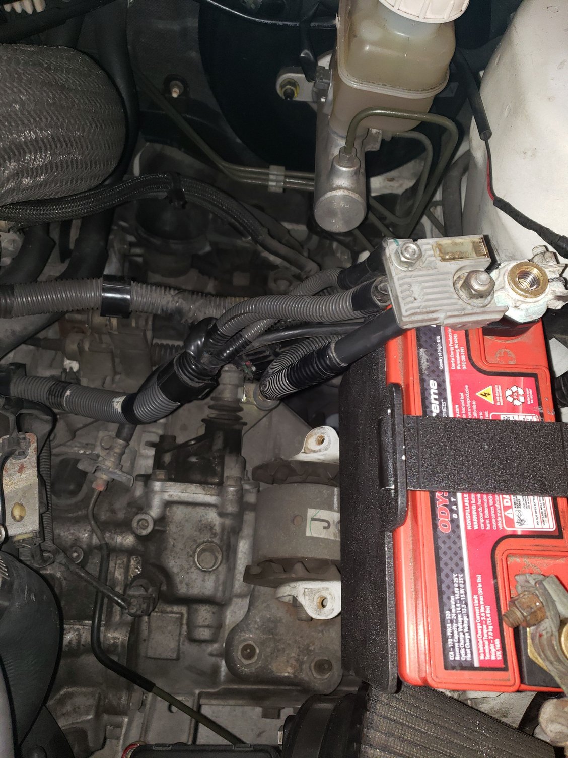

So I just did the small battery setup and works perfect but one thing I did not like is the positive cable it's kinda tight just want to see what you guys did to make a cleaner look and so on.

my deka small battery has the post on the other side... looks like having to go across the battery is making it a little tight

Yea thats the only way i can do it i seen other ppl pics of the positive on the other side and the negative in the stock location but again i would need to stretch out the positive cable but how what are ppl doing to get it like that

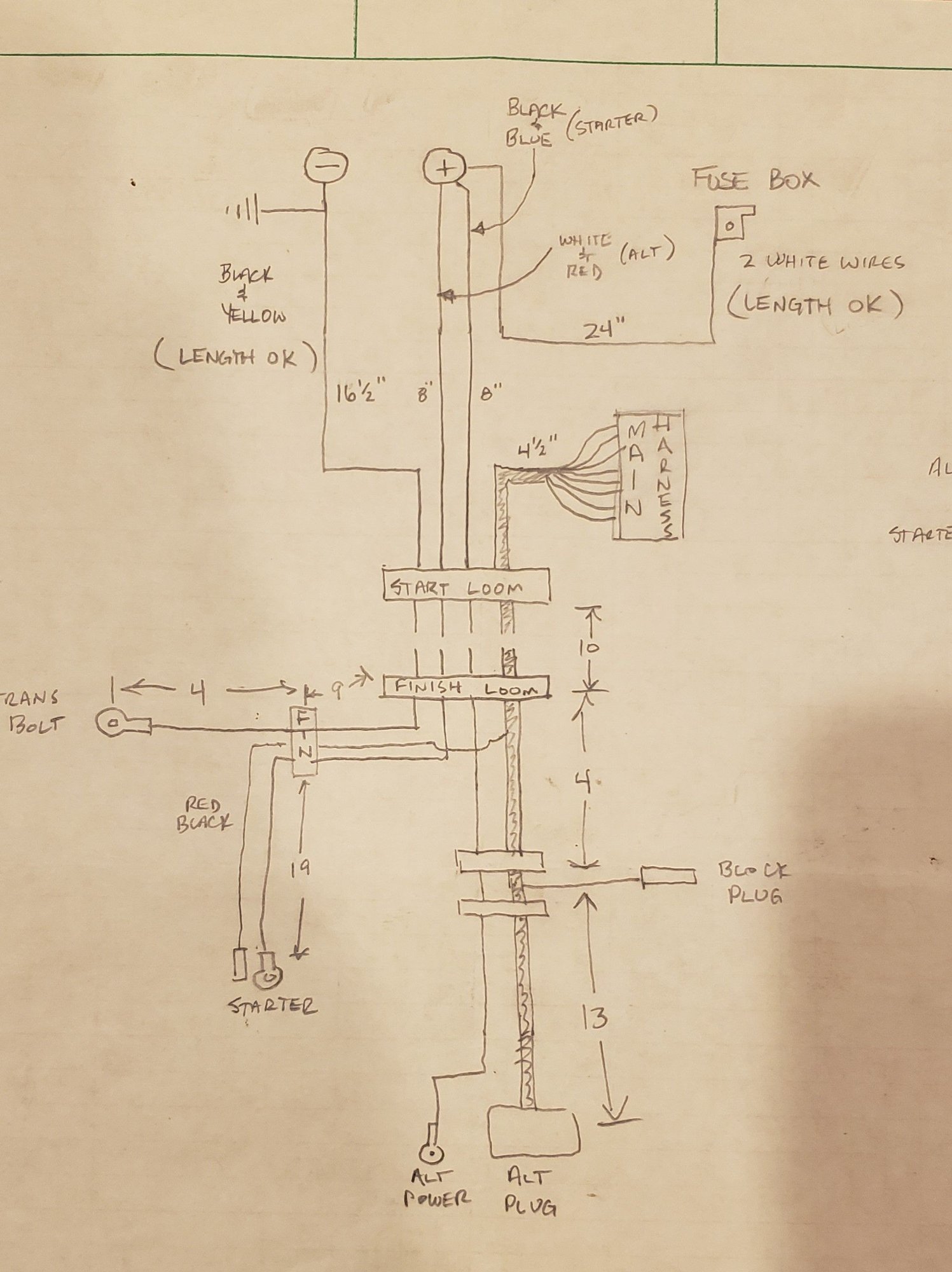

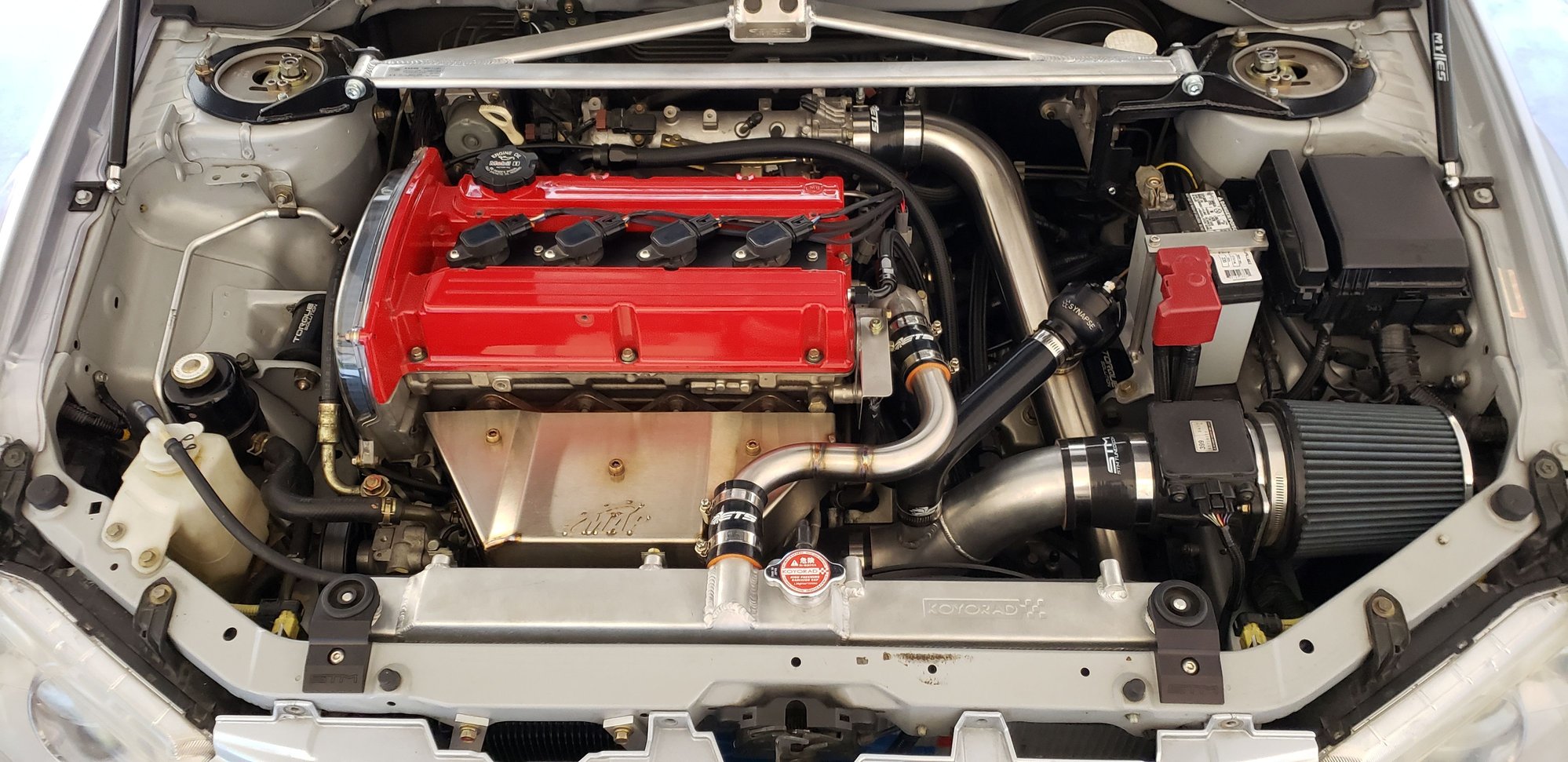

I stretched the harness while doing a mini-wire tuck. My positive post is up front and I never liked how tight it was. I'll take this sketch to work tomorrow and scan it but here's what I did. I ended up running new wire from the alternator power and the starter that was 12" longer for each. I added the length to the wire between the main loom and the battery connection.

Yea i like this look it looks super clean may i ask where you routed the wiring?
Engine bay is super clean also

The routing for this harness is exactly the same as factory, just with extra length for the battery connection.
