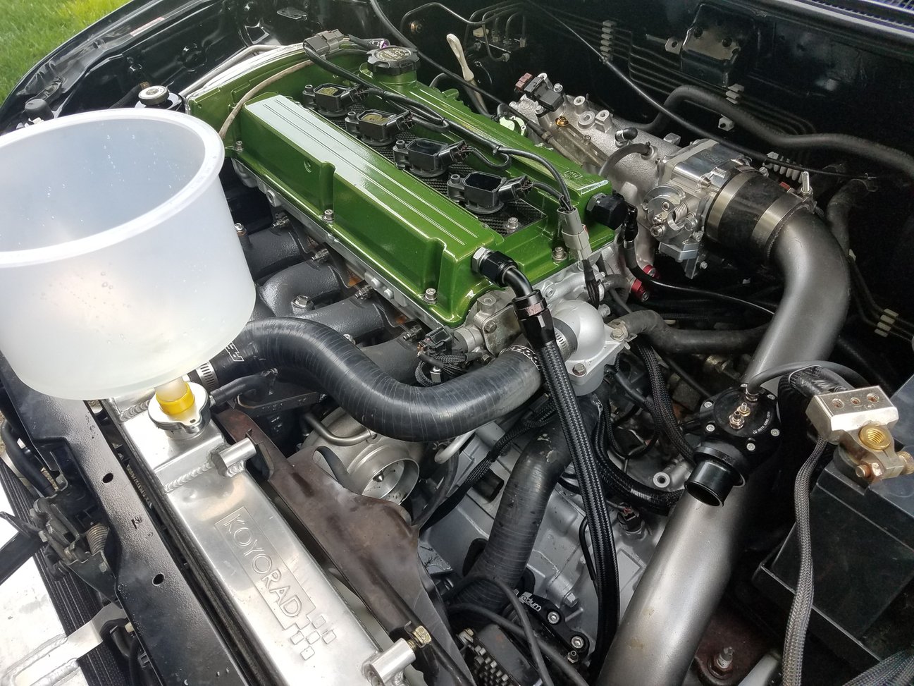

I plan on having them put a large 5/8" opening on my can since they are build-to-order (order-to-build?).
I want to go with something like this.
rjfg
