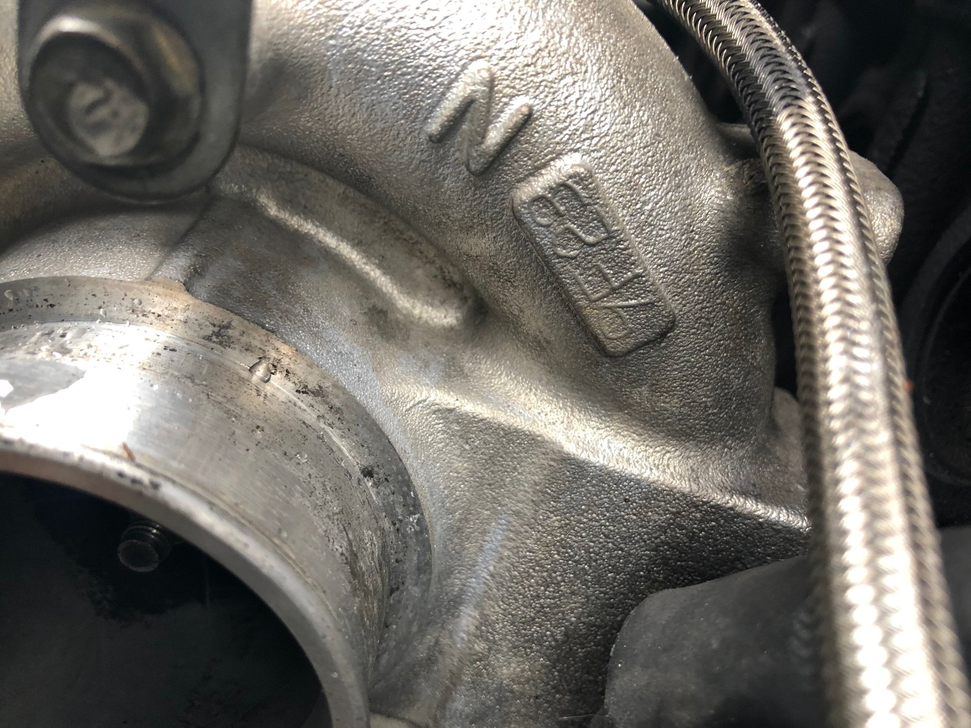

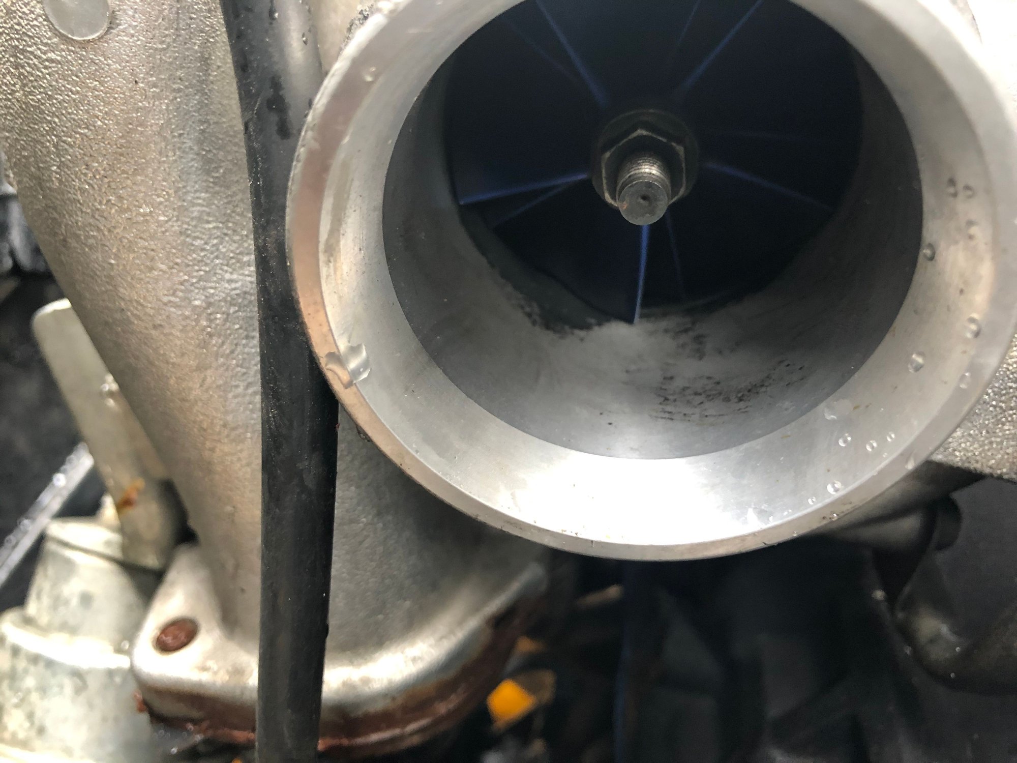

I did notice when the intake is off that the compressor wheel (cold side, right?) has a blue blade. I thought this was strange but can't see any markings on the turbo otherwise to tell me what it actually is. I will post up some pictures later to see if someone with better eyes than myself can tell me what I have under the hood of my own car lol

I did some reading on the bbk turbos when you said that and I think you are right. I don’t know if it is the full or lite but definitely a bbk unit either way. For my goals should be a pretty fantastic turbo all aroun. I can scratch that off of my shopping list.
