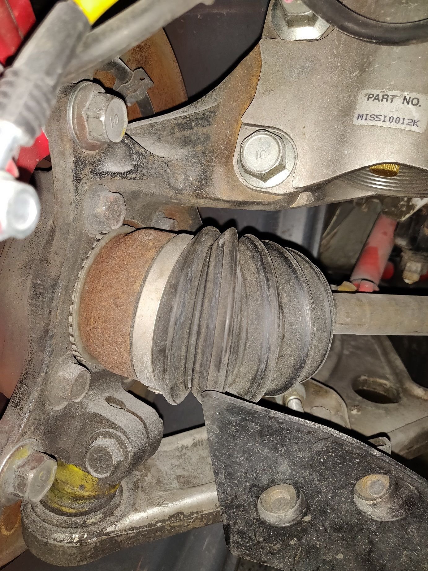

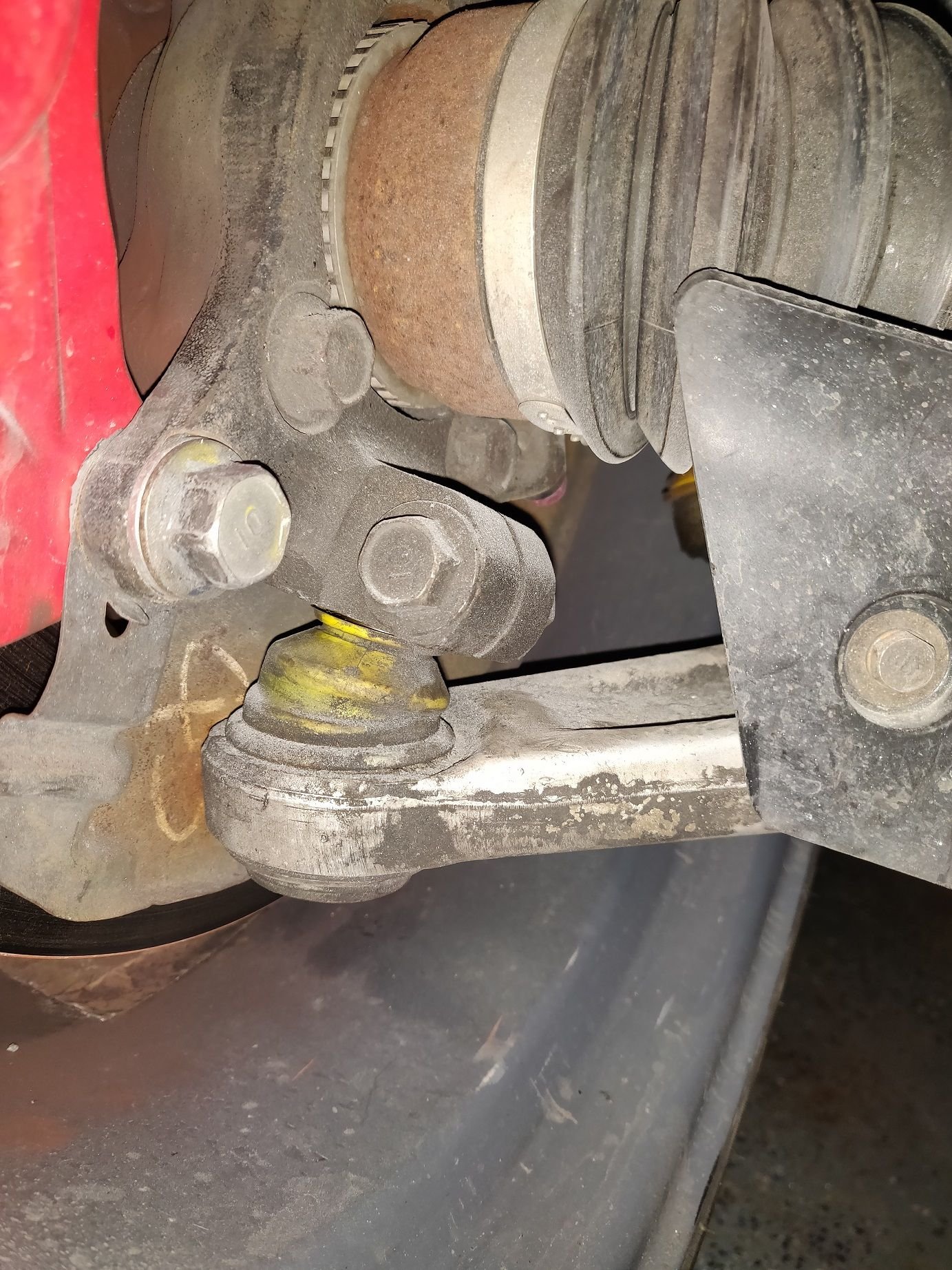

ok:
  • with the car in the air, steering cranked - no popping
  • with the car in the air, steering cranked, and I spin the wheel by hand - no popping
  • with the car in the air, steering straight, then cranked by friend as I spin the wheel by hand - no popping
so, we are looking at some sort of suspension loaded issue here, right? idk if anything can be ascertained from looking at this at full droop (wheel turned right)
